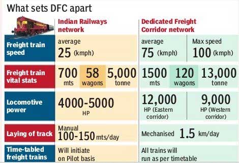

Currently, the average speed of freight trains in India is about 25 km per hour, while that of average Express train is in the range of 50-55 km per hour.
"After the completion of the work on these tracks the average speed of the Express trains would go up to 75 kmph, with maximum speed of 100 kmph, while the average speed of the goods train would improve to 50 kmph," the Railway Board Chairman said.

"For the first time we are using the New Track Construction (NTC) machines which can lay around 1.5 km railway tracks in a day," Sharma said.
Earlier around 60-70 persons were required for laying 1.5 km of track and that too in around 15-20 days.
"About 60-70 people could lay only 200-300 metres of track in a day, but through this specially designed machine we can lay around 1.5 km of tracks a day," he said.
"Only 10-12 people are required to work on the highly mechanised machine," he said, adding this makes for greater accuracy and efficiency.
Thanks to the NTC machine, it is now possible to lay rails of 260 metres -- 12 metre sections welded together -- instead of the current practice of 12 metre rails with plates, nuts and bolts.
"The rails are welded with the flash-butt method, also on an imported machine," Sharma said.
Three NTC machines have been imported from the United States and each machine cost around Rs 40 crore each. For the Kanpur-Khurja section, the machines have been imported by Tata Projects Ltd., a joint venture between Tatas and the Spanish firm Aldesa and to whom the work has been contracted.

The DFCC MD also said that once the corridor is operational, train speeds will also increase.
"Currently the average speed of a goods train is about 25 kmph. Once the construction is complete, the speeds will increase up to 65-70 kmph," he said, adding that the maximum speed could also be increased to 100 kmph.
