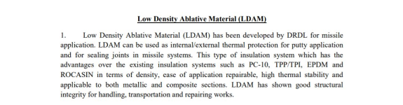

This is a rather recent ToT , November 2023 . I doubt this was used in Shaurya kind of system even though thermal stability upto 1200deg.
For external body coating DRDL has developed this LDAM & Carbon phenolic ablative tiles. If those tiles were used it would be very visible. So, I figured this would be the coating used.
For HCM they are using the YSZ coating for internal portion use.
Yes, base alloys used in combustion chambers is Nimoic alloys, Inconel alloys etc. Thermal barrier coating would be YSZ & LZ. And of course, there would be internal cooling channels.
