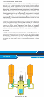

I believe this is our first look at the SMR-55's tentative design. My initial thoughts are that the primary loop seems to be an extremely compact, volume-optimized package. I would think that's pretty much par for course given the goals of the program.
However, I can't help but point out the parallels between the way the primary loop components, e.g. reactor pressure vessel (orange part), steam generators (blue parts) & what I think are coolant pumps (green parts in between blue cylinders) are arranged on the SMR-55 compared to how they are packaged on a submarine PWR like the OK-650B (2nd pic).
Yes, form follows function (submarines are another use-case where compactness carries a lot of merit), but I won't be surprised if there has been some cross-pollination between the design work for this SMR-55 and the Indian Navy's CLWR-B2 meant for our next-generation nuclear submarines (S5-class SSBNs & Project 77-class SSNs). Both are light water reactors though the B2 is meant to work with much higher levels of fuel enrichment.
