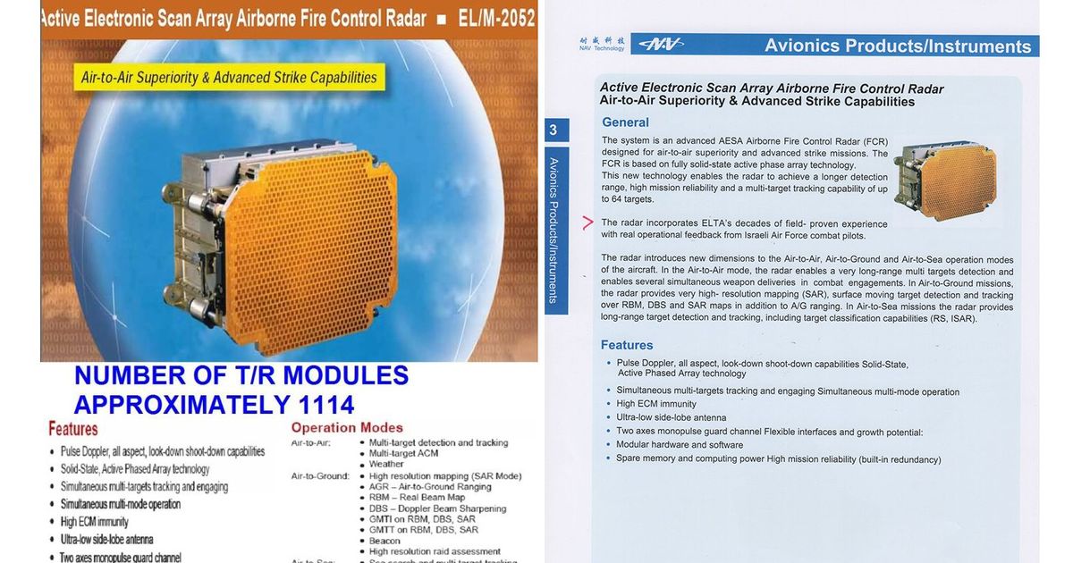

Are you kidding? Dont make me laugh.
Radar mode needs to change during close combat. And there is sub ACM mode during usage of gun(it change the search range and elevation), where we get a lock on during gun operation and that's how CCIP is calculated.
3862537_brochurecombo_jpeg6f18f294e91266d9bf42ff9f2829027f
Read it in operational modes and air to air modes.
Still don't believe me, here is the manual of F/A-18 E/F

@Arpit, You probably misunderstood @randomradio. He meant that Fadec has no ACM mode nor do FBW has any ACM mode. Air intercept radars have ACM mode. In Sea Harrier Bluefox radar this mode was called supersearch mode and used during ACM. This mode selection was part of HOTAS controls.

Yeah, but it has nothing to do with engine and FBW.
