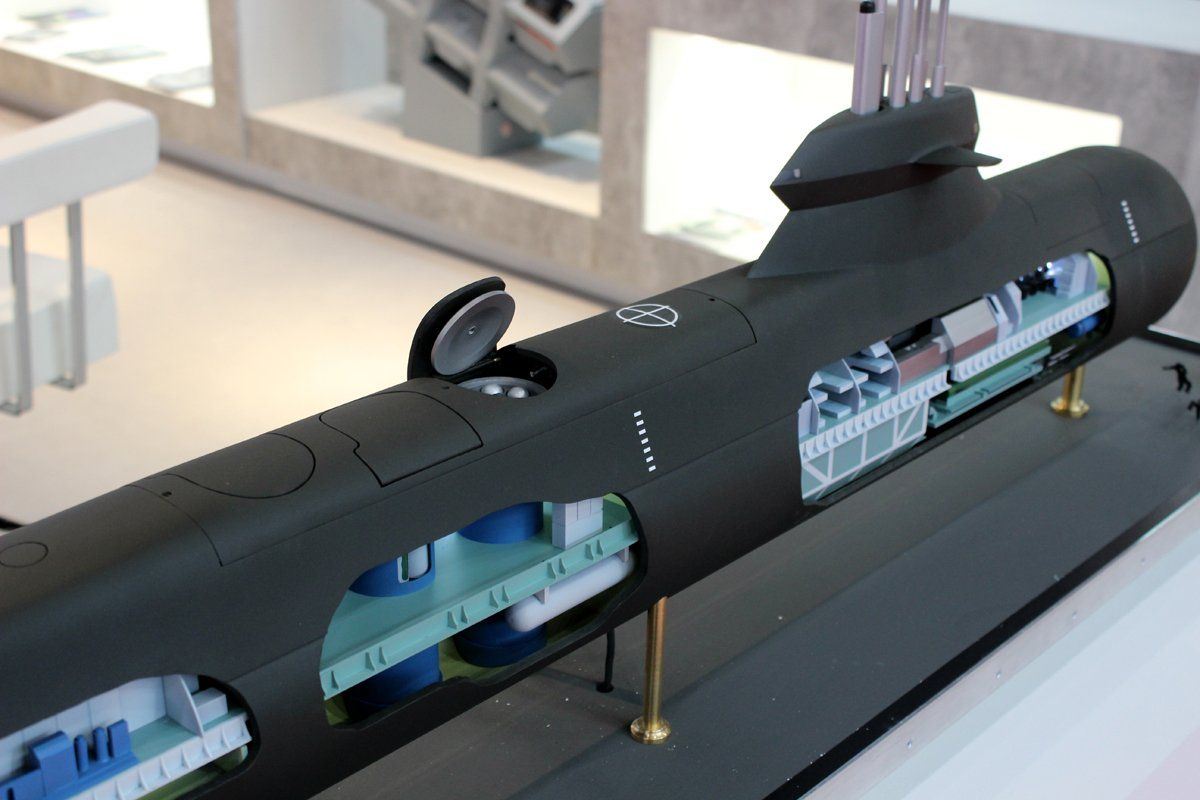

A-26 (Blekinge class) is a superior choice. Significantly quieter AIP versus previous designs, innate special forces support capabilities with built in special forces support facilities, sleek design built on the GHOST philosophy (Genuine HOlistic STealth) and increased use of automation (there is no command center on these subs, the mast is entirely automated) and a optional 18-cell VLS.
3 different sizes are offered for export. A-26 Pelagic from littoral operations. At 1000 tons, with a 4000nm range and endurance of 20 days it's Swedens choice for operations in shallow Baltic waters. The A-26 Oceanic up endurance to 30 days at patrol speed and 6500nm at 10kt. Displacement is 2000 tons.
India might be interested more in the A-26 Oceanic (Extended Range) with a displacement over 3000 tons, a range of 10,000nm at 10kt and an endurance of +50 days.
Sweden's submarines are fairly unique in that they use wire-guided 400mm torpedoes. (alongside Saab's Torped-62 heavyweight torpedo). Wire-guidance allows for smaller lightweight torpedoes to be tandem fired, and is far more reliable then traditional fire-and-forget lightweight torpedoes when operating in shallow and crowed Baltic waters. Sweden holds the record for the most torpedoes launched and guided simultaneously owing to these unique torpedoes.
Their ability to support remote operated vehicles is very strong, being a design that was from the ground up designed to support both special missions capabilities provided by ROVs, AUVs and special forces. The AUV-6-MR is the standard autonomous vehicle launched from the torpedo tubes of a Swedish submarine.
Because these submarines were offered to Norway, alongside the German Type 212CD and French Scorpene' I've had a chance to review not only their design, but work directly with our Swedish counterparts on some of the more intimate details of their designs and I can say with utmost confidence that the A-26 is one of the best designs out there today. Ultimately politics will decide, it always does in tenders like these, but I'd favor the A-26 over all other contenders knowing what I do about the design.
Swedens a good partner to work with too. Accommodating, though sometimes they have troubles keeping up with deadlines or schedules (Archer tender I'm looking at you), but owing to their own budget limitations they produce cost-effective designs and are willing to work with a partner to refine or redefine a program to fit both nation's needs.

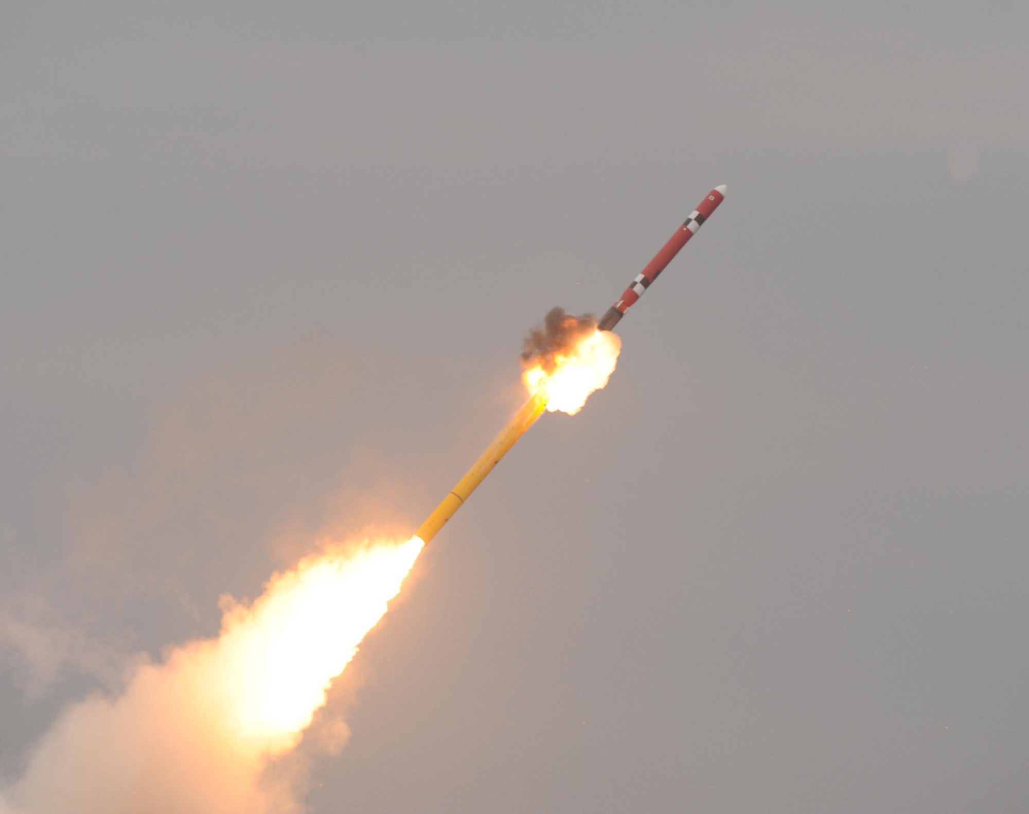

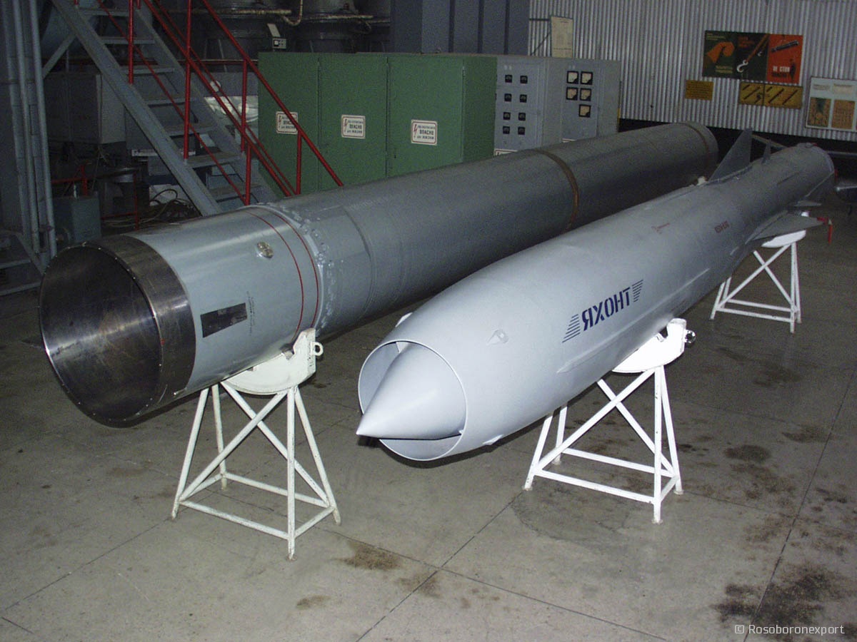

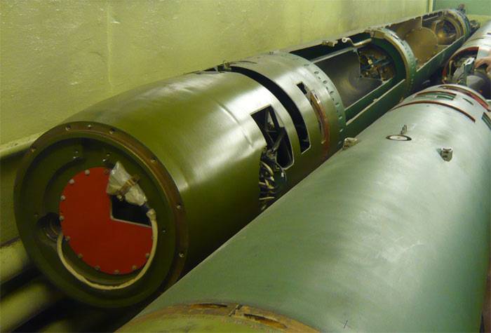

Only Russia uses 650mm torpedo tubes, generally for the Type 65 torpedo:
But also for firing the submarine launched RPK-7 variant of the RPK-6 anti-submarine "torpedo-missile".
These missiles are going away in favor of the RU-100, fired from traditional 533mm torpedo tubes and the 91RE1 variant (submarine launched - shown below) and 91RTE2 (vertical launched) of the Kalibr cruise missile family.
Can't imagine the 650mm tubes of the Oscar II, Typhoon, Akula and similar Soviet era submarines will last much longer.
So no, Sweden wont be adding any to their designs, nor will Japan because outside of Russia and its Type 65 and RPK-7 no one else uses 650mm torpedoes rocket/missile assisted torpedoes.

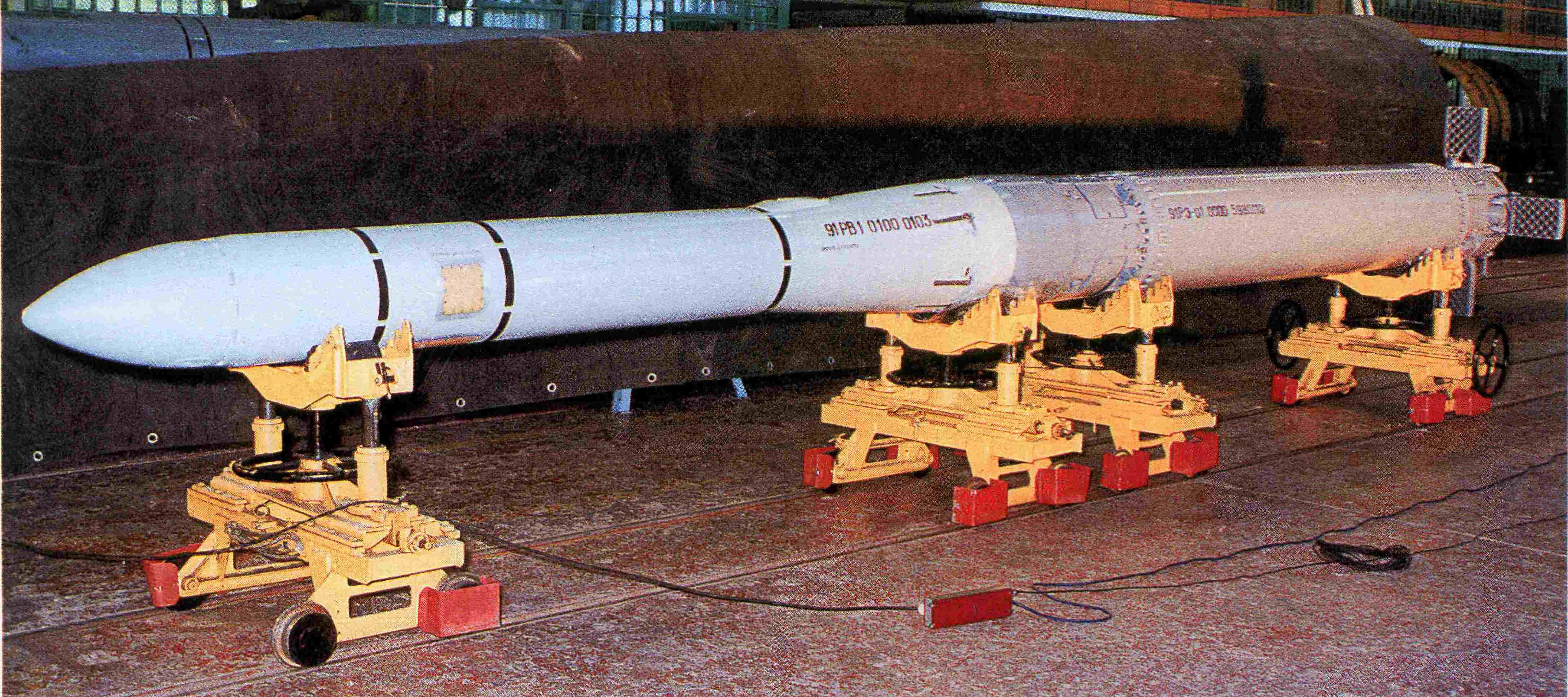

A smaller Brahmos maybe, but the missile (and derivatives like P-800) are a fair bit longer then the missiles envisioned on A-26, which wasn't expected to have any Russian origin/cooperatively designed equipment on them.
P-800 for instance is 2.5 meters longer then Tomahawk and though the missiles launch casing is fairly thin, it's too long for A-26 to accommodate.
main-qimg-1a96d4a3f52861cda777d043fd5e4235
Tomahawk, Hyunmoo-3 and MdCN are the class that'd be used on an A-26. So Nirbhay could be an option once it matures enough for use on submarines. Some variants of Kalibr too, but they range from 6-8 meters.
