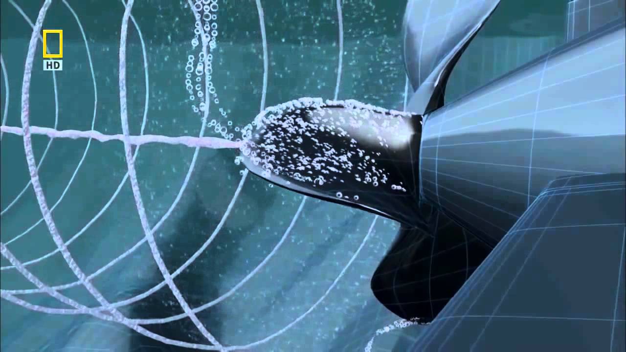

Here's a question for you Randomradio, a basic question; how do you quiet a submarine:unsure:? I'm not looking for generalities here, but specific design features.
es not have diesel submarines. Even France sells diesel submarines to everyone but does not have it itself

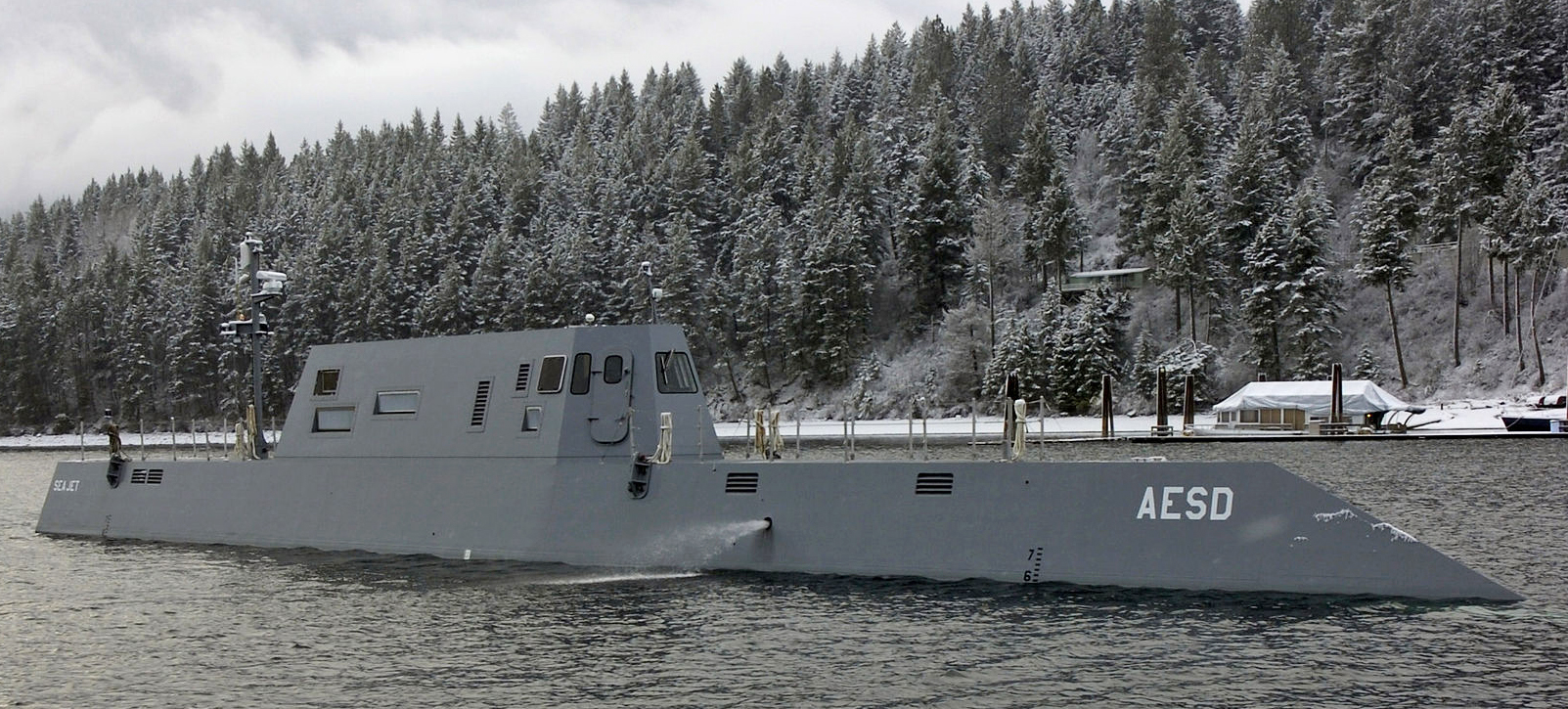

Not true entirely. The US doesn't operate DE or AIP submarines, yes, but they have designs. These designs are being upgraded frequently as newer technologies and tactics come online. While they don't use the designs themselves, or have shipyards with experience building DE or AIP subs, they do consulting work with foreign partners on submarine design, such as with Taiwan, Japan and Norway.
The designs aren't on paper strictly, there are a number of hull designs that have been tested at subscale.
Non-submarine designs too, to validate various signatures and the hull designs themselves.

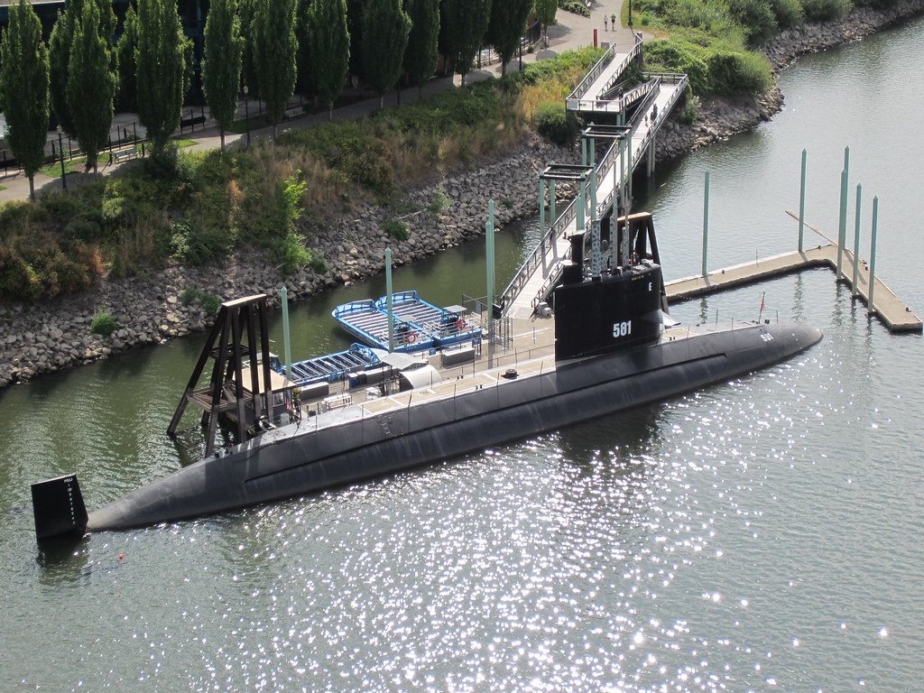

The last DE submarine in service with the US was the Barbel class, though variants are still in service with the Netherlands and Taiwan
USS Blueback is well worth the tour if you ever find yourself in the US state of Oregon. It's moored at the OMSI museum.
Of course they're possible with existing designs. Just use newer materials when building new submarines, that allow them to dive deeper, not that that's even necessarily a good thing anyway (the deeper you dive the longer it takes to safely get back to the surface, changes in weapons and sensor performance as water temperatures change and topography alters, subs can already dive and operate deep, but operationally don't, etc.). A design is just a blueprint. They can always be revised.
Um.... If you revise an existing design, with say, an extra plug for AIP, and then an extra plug for a VLS, and then an extra plug to carry more fuel, and then you upgrade the engine to lug all that weight, then you basically have a new class.
I know only the general stuff.
Say, all electric propulsion system, so that you can eliminate the reduction gearbox.
Sound dampners to absorb the vibrations from engines. You can have isolation materials running along the inside of the sub hull. You can place equipment on rubber mats. Join pipes using flexible materials. Anechoic rubber tiles on the outside to absorb sonar generated sounds.
Scewback propellers on most SSKs. Pumpjet on bigger subs which can generate more electricity.
Deperm to remove the hull's permanent magnetic signature by wrapping it with solenoid coils and isolating it. And then, continuous degaussing with a counteracting magnetic field to reduce external magnetic influence using onboard electro-magnets while the sub is in operation.
Low noise lighting for use inside the subs.
Better production techniques so that gears and other moving parts connect more seamlessly.
Then basic tactics:
Move slowly.
Crew being more discrete.
Stay below the thermal layer, at least in warmer regions.
The deeper you go, the less cavitation from propellers.

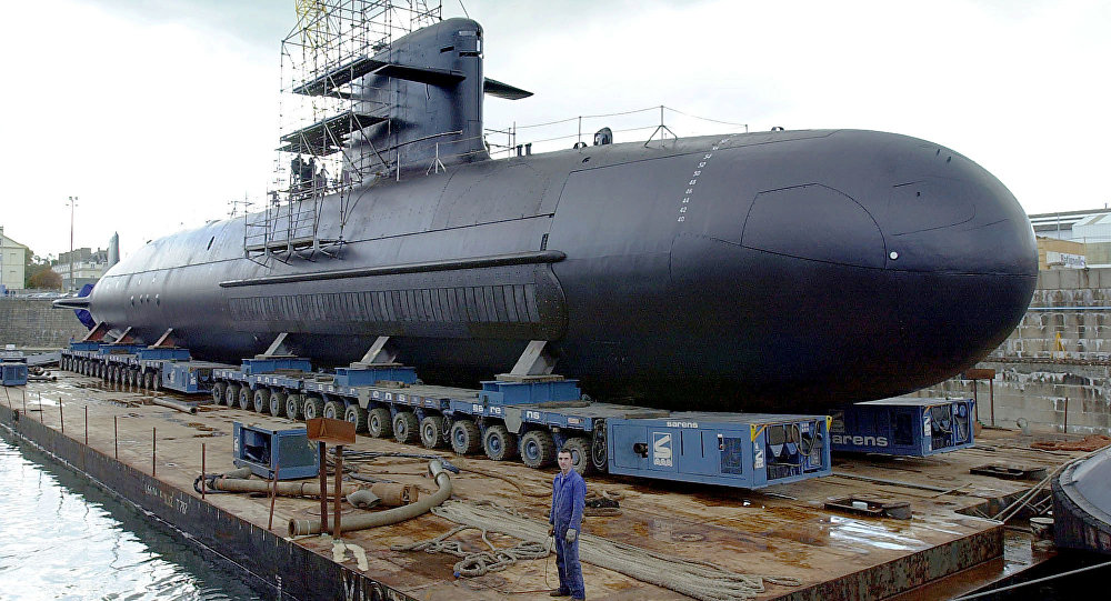

What do you think of Scorpenes...Are they any good??
They're pretty darn good, comparing favorably with the Lada-class (AIP, not the current DE designs), Type 214 and S-20 (with the optional AIP module). Similar design (length, beam, draught), stern plane arrangement, tower design, torpedo tube numbers, propulsion type. Nothing that sets them apart, though their really, really quiet owing a lot to their internal systems and stores mounting arrangement (rafting), but they're among the best submarines around today.
I had a chance to review their design during contract negotiations between the French and Norwegian governments, as we'd (meaning me) would have major contracting work on any potential Type 210 replacement and found them to be a great option, though ultimately we decided to go another route. There are two problems I found with the Scorpene during the design review, and keep in mind the actual results are classified, sorry:p, so you're only getting generalities from me based on my assessment during review.

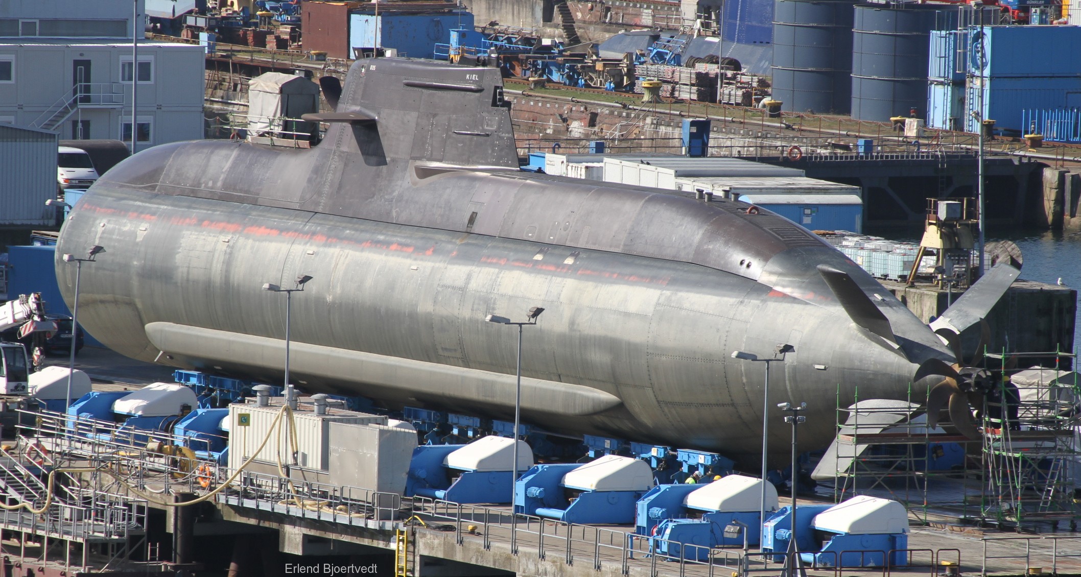

1. The Type 212A is simply a superior design when it comes to signature suppression and maneuverability at slow speed, which is ideal for an DE or AIP design. More hydro-dynamically streamlined, X-stern plane versus cruciform allowing for superior shallow water maneuverability, non-magnetic hull and interior machinery, quieter.
1a. Where the Scorpene came out ahead was in endurance, range and diving depth, duration and frequency, and the AIP design, which is more reliable and less dangerous versus fuel-cells. It's also very reliable and has quick turn around during maintenance, owing to high levels of automation, allowing for more days at sea and carries a tad more torpedoes, mines or missiles, which is nice. Scorpene is basically a small SSN hull (in terms of materials used, shaping, etc.)
2. France is a crappy partner to work with.
Other then that the Scropene are pretty much the best around today.

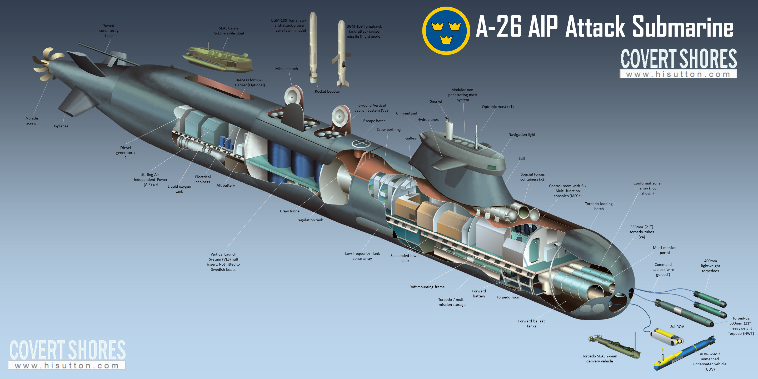

I can't wait to get my hands on the A26:devilish:.
*I should add that the Type 212 I reviewed isn't the Type 212A of today but a submarine design called Type 212CD (common design), formerly known as Type 212NG (next generation/Norway-Germany). I used the Type 212A as a comparison owing to the classified nature of Type 212CD design elements. Sorry, but not even breadcrumbs about its design. I've got work to do on the Type 212CD so my lips are shut:censored:.
The likely options for us seem to be larger versions of the Scorpene, Type 214, A26 and a Russian sub (likely Project Kalina).

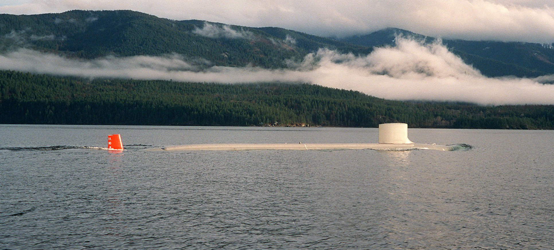

No. The info leaked - internal rafting arrangement, propeller design, performance, acoustic dampening means, etc. - it's all bad to have leaked, but it's not damning to the submarine. And why? Because these data points aren't static. Noise generation, frequency and harmonics are unique to a given submarine and only known after the submarine hits water, and stored locally in the submarine's Ship Data Book, not on a corporate power point.
Shown here is a baseline acoustic signature test. The noise levels of the submarine will change at different thermocline grades will at sea as sonar and sound travel differently through alternate thermal layers.
Likewise noise levels will change based on speed. Not just because machinery gets louder the faster the boat goes, but due to increased cavitation, which as the bubbled produced pop, gives of a highly noticeable sound signature.
Knowing the frequency of the submarine's sonar or electronic signals gathering equipment isn't helpful either, since these are mainly passive. A submarine can use active sonar, but that betrays their position to anyone with a hydrophone really quickly. In 30 years of service with the Norwegian Navy, the number of instances where a Type 210 has used active sonar are in the single digits.
