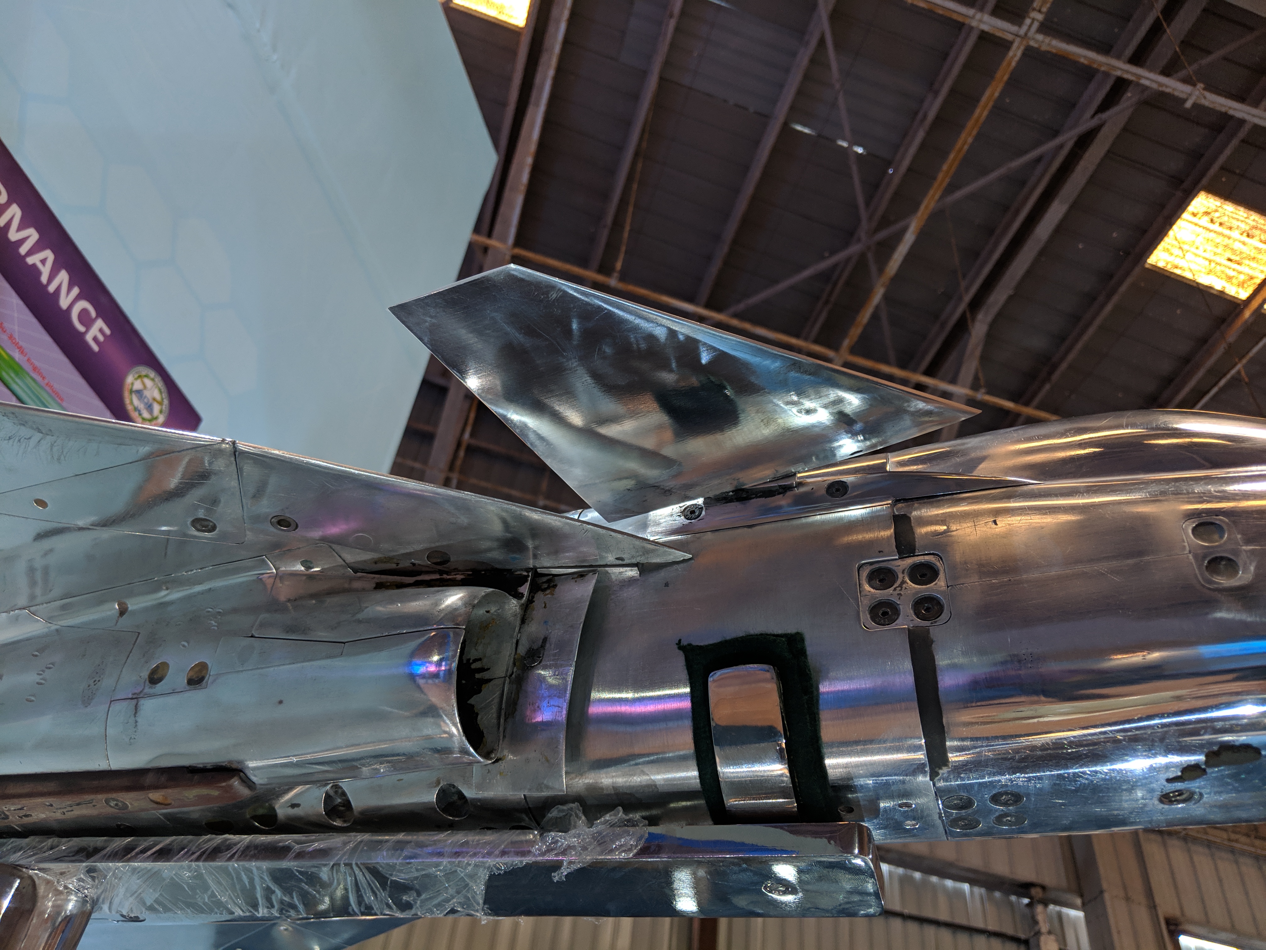

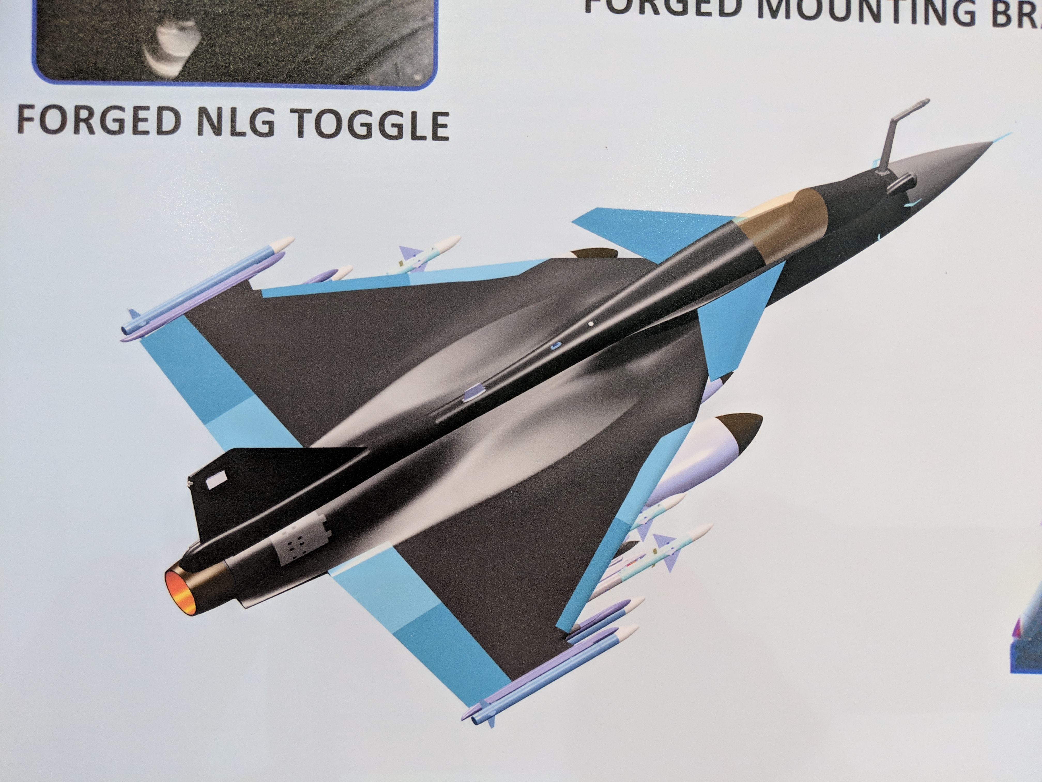

The air inlets seem a lot more slanted than the Mk-1's? Aerodynamic improvements are to be expected, so no surprise though -
The air intake is made wider at the inlet section to cater for higher mass flow for the new engine. This gives the impression of the air intakes being more slanted when viewed from this angle.
The current GE F404 engines have an air mass flow of about 153 lb/sec as against the figure of 170 lb/sec for the GE 414. The higher mass flow requirement results in a wider inlet section for the Mk2.

looks gripen E-ish to me
Both are delta canard designs.
ADA should have designed the LCA with canards right from the beginning though.
Gripen E entered the assembly process this month. We could have been doing the same had we planned LCA with canards right from the start. Too late for that.

Actually besides having a canard, its nothing like Gripen - E. Gripen honestly has a better aerodynamic design with good performance improvement with their Canard-Wing arrangement, and they have made real improvements with regard to mid fuselage arrangement and landing gear compartment. I'm with @Vstoljockey on this one, it's really difficult to make out how useful this canard arrangement will be on Tejas. All they have done is lower the leading edge of the wing at the root and make space to attach a canard there. The leading edge of both the canard and the wing root is surprisingly close and with very minimal clearance, this will also result in limitation of canard deflection angles. For some serious performance improvement, the only choice was to redesign intake/wing/canard arrangement which is not an option right now due to the amount of time required to design and test all that. What were they seriously doing for the last few years apart from bringing different scale models to every AeroIndia shows?

You are taking it too literally, comparing nuts & bolts - i explicitly mentioned "ish" at the end for a reason. Center fuselage tender hasnt released wings design detail yet, so a lot is left to imagination of how it would be, Canards are defiantly there.
Never said its a Gripen E & cant deny whats released in tender has some similarity to Gripen E - Hence my stress on "Looks"
