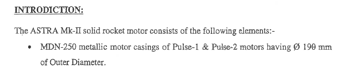

Nope. Missile body length is exactly as Astra but with TVC vanes add-on which makes it slightly longer. Its diameter is also 178mm, exactly that of Astra. Now the catch is that Astra 2 also has 178 mm diameter with a thicker mid-section(rocket motor part) which is around 190mm in the mid-portion.As I said, I'm only speculating. I remember reading that the VLSRSAM is noticeably fatter/longer than the Astra-Mk1.

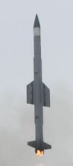

I debated about this with @Gautam sometime back. Now with VL-SRASAM tested against a NOTAM of 75kms; kind of confirms its Astra 2 origins. And thanks to this pic posted by dear @marich01, we can see that one missile out of two tested had indeed thicker mid-diameter. Also Astra 2 also has an AESA seeker. Looks like the same was tested too:It's probably the Astra Mk2 in surface launched config. We'll know for sure when the specs of the Mk2 are out.
^^ The thicker mid-portion is very apparent here. Of course, the obvious "doom & gloom" guys will continue to blatantly ignore the 75kms NOTAM for the above test(s) and this pictorial proof as well.

Those TVC vanes VL-SRSAM has got, may allow it to turn harder than Astra series missiles as long as motor is working. That's is why, it being based on Astra MK2 makes more sense as Astra MK2's dual-pulse rocket motor would kick in the endgame and allow those TVC vanes to operate even in those conditions which may increase the 40G turn limit even further.Astra mk2 dia is 190mm, anyway if they even turn both astras into srsam role specific, they will almost certainly change the motor characteristics ie burn rate and possibly the burn time with a slightly longer motor. But visibly we will not be able to distinguish from afar. The 80 km claim came from DRDO/MoD sources, contrary to us finding it out from usual less stated range so lets see. Most likely given the outrage DRDO will fall back to old 30km figure.
