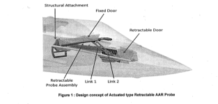

How? Amca will have retractable probe, so how does receptacle help in reduce rcs compared to an retractable refulling probe?
Or are you talking about during refuelling? If yes, Really?

They can have retractable refulling probe too.
Good question, you are designated as senior memeber, i thought you know this - Surface discontinuities, crevices, gaps, bumps, round surfaces, vents, etc contribute to RCS.
Although different RF bands react differently, so it is diicult to optimize a jet for all bands, but efforts are being made.
So IFRP will contribute to frontal & RHS RCS.
But a spine receptacle is smaller, hidden from lower hemispherical angles.
The panel on top of IFRP seems pretty flush to my eyes.
Same case there for f35, its hard to distinguish the panel when IFRP is retracted
A very shallow theory, not taking into account that you can make the IFRP flush with rest of the surface when retracted, F35 already demonstrated it.

Just like boom have all these, IFRP also have their own design points & systems, like Refueling probes are engineered with shear rivets (or shear pins) at the nozzle tip, These rivets are designed to fail—intentionally breaking the valve off—if the side or vertical loads on the probe become too high.
Position Indicators: Electronic sensors monitor exactly how far the probe has entered the drogue.
Load Protection: Systems like Eaton's Weak-Link Load Protection provide real-time data to help prevent stress overloads.
That's another assumption, f35 has already demonstrated in real life about having an IFRP that is flush with rest of the surface when retracted.

Gaps around the door/panels are filled with conductive seals or radar-absorbent material (RAM). The entire surface (including around the door) is coated in RAM. Tight manufacturing tolerances keep any remaining gap far smaller than the radar wavelength, which results in No significant "edge" for radar waves to scatter off in the closed state.
Typical fighter/ground radars use wavelengths of 1–10+ cm (X-band ~3 cm, S-band longer). Features much smaller than ~λ/10 (a few mm) behave very differently—they don't produce strong specular reflection or diffraction in the same way. A "flush enough" panel (sub-mm tolerance) is electromagnetically indistinguishable to radar.

Your prime argument of reduced RCS is a debatable point, as you can make a panel that opens & closes,
flush enough for it to be indistinguishable for radar waves from X to UHF/VHF.
Your priority is to reduce cost at expense of pilot's life risk, while my priority is spend little more money to reduce RCS & increase pilot survival chances.
Your priority is to do mental gymnastics to some how fit your claims, with you treating a debatable point as truth and arguing use that assumption as base.
Rest your arguments also uses that *reduced RCS* point as base, so I won't engage with them further.
FYI
In general radar physics, a wave "ignores" or does not significantly reflect off a discontinuity that is smaller than half its wavelength, For X-band radar, which has a wavelength of approximately 3 cm, this means features smaller than roughly 1.5 cm will typically not produce a strong enough reflection to be detected as a distinct object.
Also FYI.
We are going with a retractable IFRP for our future stealth jet.
You're opinion is not just different, its factually wrong, supported by shallow misunderstandings and mental gymnastics.
If it was actually true that panels that opens&close creates enough of an edge to make a meaningful dent in stealth of a jet, than F-35 wouldn't had an novel feature like internal ladder built in too.

But the point started with RCS reduction of AMCA with spine receptacle & boom refuelling, not capability of 3 jets refuelling same time,
FYI
Also FYI.
If it was actually true that panels that opens&close creates enough of an edge to make a meaningful dent in stealth of a jet, than F-35 wouldn't had an internal ladder built in too.
