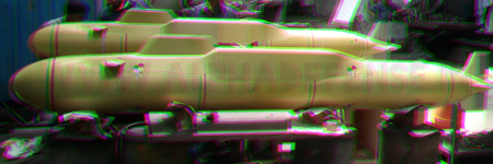

Where is this pic from?
Yes, it's one of the known S-5 models.
Bro, look where the raised 'hump' ends on the S4 and where it ends on the model. See how little space there is after the raised section on the model compared to S4. Perspective cannot account for all of it.
The taper toward the stern begins almost immediately after the raised section ends on the model. But not on the S4.
Those white/grey tube-like things on the model are test fixtures that attach to a control rig designed to keep it steady at a particular depth or to assist in pitch/yaw movements, like this:

^^ The 2nd pic is an AUV but the principle is the same. It's called captive planar motion testing.
Those fixtures do not correspond to missile tubes. You can see there's one even all the way at the back of the raised section, where the reactor is supposed to be.

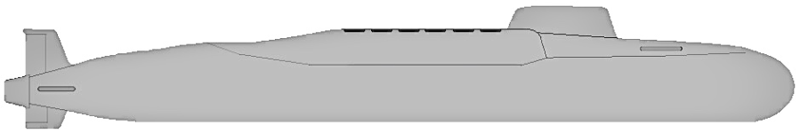

Iirc, the earliest depiction of S5's hull design was shown in a DRDO/NPOL brochure showcasing its integrated sonar suite much earlier (Defexpo 2014?).
Back then it featured a pronounced hump with blended sail, not much different from Delta 3/Type 094 Jin class boats. So the design has seen some iterations but I do not expect it to be a teardrop shape like Dreadnought or even the Ohio.
This is actually the original Project 935 Borei class design (not the Borei that finally got built, which was a fully redesigned sub under Project 955).
This early iteration was planned as a direct successor to the Delta-IV, as you see the lineage clearly shows. Our agencies just reused that old design as a placeholder as they needed a graphic to display that sonar suite.
And who knows...maybe this Pr. 935 design was transferred to us 🤷‍♂️
Possibly. Its also possible that Igorr Spasky might have came up w/S5's design after having worked on the Arihant's. Rubin DB has had a long association with the IN going back to the Chakra I SSN.
