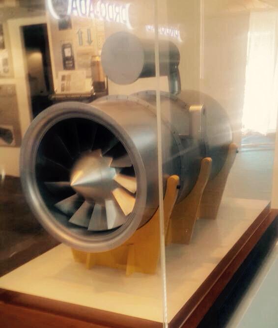

In its five development tests, the Nirbhay has been powered by Russian NPO Saturn 36MT mini turbofan engines. The DRDO’s engine laboratory GTRE (Gas Turbine Research Establishment) is currently steeped in developing a similar indigenous mini turbofan engine called
Manik in deep collaboration with the Centre for Propulsion Technology at IIT Chennai and IIT Bombay. Ground runs of the engine are slated to begin this year.
Manik mini-turbofan for Nirbhay
“We are developing the three versions of Nirbhay now. The Manik engine should be ready for testing in two years. By the time user trials begin, we hope to be in a position to offer Manik-powered Nirbhay, at which point the system will be over 95% indigenous. This is a major task for us since this is something we have to prove to the world,” Christopher says.
