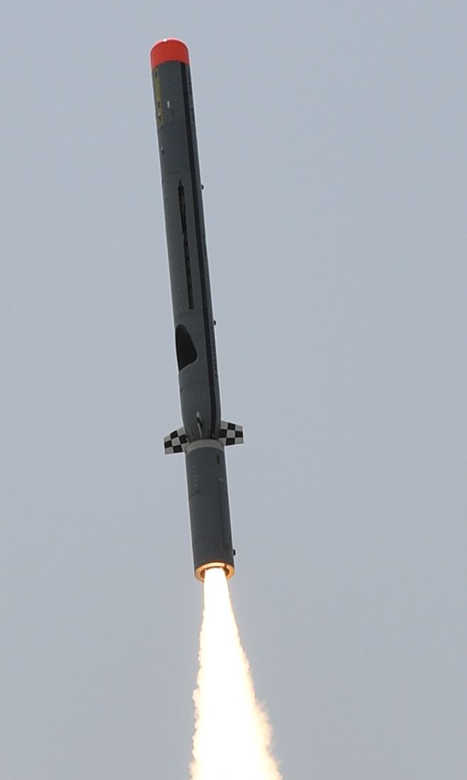

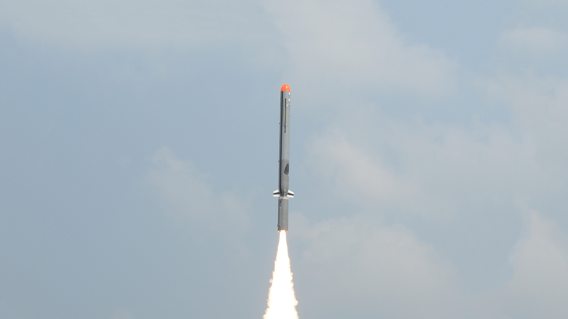

Another difference appears to be that in the latest test model, the slits for the glide wings are positioned much farther to the back (toward the nozzle) than previous models.
New:
Old:
The wing has not changed position .....Its just the other side of the missile .
Nirbhay uses a single piece wing rotating to the position on a single pivot ... so one half of the wing rotates from front of the pivot to the position while the other from the back .
