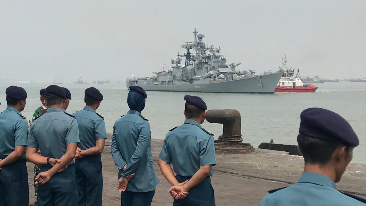

Did they replace SS-N-2D Styx with inclined Brahmos?
@Parthu @GuardianRED
India's L&T develops inclined launcher for BrahMos cruise missile | Jane's 360
INS Rana last month
INS Ranvir during INDRA ex
Good Catch
We do know that the Rajput Class is been used for missile testing for the Brahmos , ie for the inclined - INS Rajput and VLS - INS Ranir, INS Ranvijay - which is now become part of their weapon system
From your post, we do NOW know that INS Rana and possible INS Ranjit isn't part of that program ( Possible reason being that these hulls are part of the Dhanush program) hence - haven't yet being upgraded to launch Brahmos
Really wish that the IN have some sort of Standardization among the different hulls - and Now even within Class of ship there isn't standardization among them too :( .
Another example is INS Mumbai not having the Barak 1 System on board while INS Delhi and INS Mysore has them.
