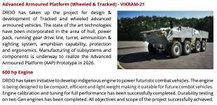

It's strange they say level 5/4 here but TASL specs say only upto level 4 and 2B blast (when it should be 3B from what I have seen beforehand).
Also I don't understand why they have given it extra thick panels on 1/3rd of the frontal sides if it's indeed only upto level 4 because STANAG doesn't need a protection arc for this level.
