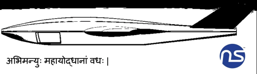

What's the stealth feature of the above platform are they compromising it?
Stealth is fine. It's a small aircraft with serpentine intake, twin canted tails, IWBs & all composite skin. Will probably get radar absorbing paint coating later.
The only part I am not a fan of is the intake. I would've loved to see a submerged intake like the one shown on the mockup. But that intake would have some problems of boundary layer separation. Maybe they switched to this raise intake to derisk the design.

I sure hope this is not the final design. They set a high bar with the mock-up design at Aero India '21 and now this...
It cannot be final design bcoz we're jumping 1st time into full scale jet powered UAV. HAL might be producing few more TDs toexplore different aspects.
There are many designs like this worldwide, still in experimental stage by private companies. Some not flying yet could be misleading.
> Well be exploring V-tail. It is huge, I would expect all-moving shorter tail.
> This TD is not even RCS optimised.
- The sweep angle of leading edges of wing & tail aren't much.​
- Big pitot's tube on wing.​
- Intake front edge is vertical & sides are semi-circular.​
- Landing gear doors & other riveted panels are rectangular.​
All these things woud be expected in upcoming TDs meant for RCS testing.
> I would expect IWB to carry 4 BVR-AAMs & SWB to carry 1 CCM each. Light payload will force the UCAV to retreat out of battle very soon. The AAMs can miss targets due to enemy's tactics, jamming, decoys, etc.
> This size UCAV, globally made by any maker, will face threat from 4.5gen, 5gen jets also. It can't bet survival only on RF stealth.
> Manned or unmanned, it requires tactics to fight enemy jet, like maneuvering, evading enemy missile & SAM, staying out of heir NEZ (No Escape Zone). So afterburning engines coupled with lower drag wings can help, otherwise from cruise missile to subsonic jet can be easy targets.
> If this UCAV is expected to perform high AoA then again afterburner may be required to compesate for bleeding energy. And then the intake should be below or on sides, otherwise aerodynamic shadow would create low pressure, stalling the compressors.
