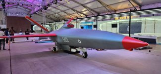

Why was the previous intake of Half Cats Warrior changed? It looked more futuristic, did the newer design have enough performance improvement to warrant such a change.
It's not about futuristic or, aesthetic solely by compromising capability. The previous design of air-intake was limiting the internal payload capacity. The CATS warrior is a small wingman machine. We need to meet the full potential of its usage. After the design change the internal payload capacity has increased. Also it will reduce the IR signature of the Aircraft through smaller Air-intakes which will eventually increase the stealth character of the machine .
