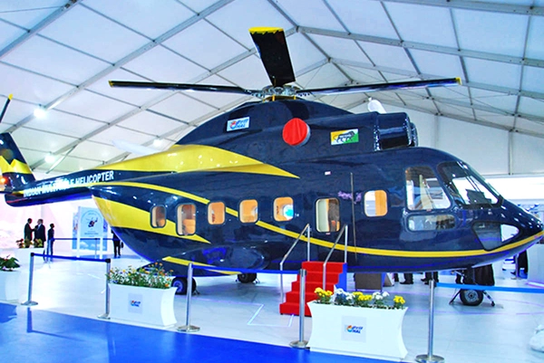

Does this mean the design could still change? I'm nitpicking but HAL seems to be following the same design template as ALH across all its new designs, be it LUH or IMRH. The only thing that's new in IMRH concept is the tailplane with its inverted tips, typically seen on AW-139 helos.
A fresh design would be nice but I'm not holding my breath.

Not really. The DBMRH variant for the IN will be smaller afaik (~10t vs 13t MTOW for the basic IMRH version). Other navy-specific mods like folding rotors, tail boom and outriggers/pylons for weapons, etc can always be added post-design.
To be clear, I'm not asking for a total overhaul. But I would have appreciated a diamond cross-section/angled fuselage, flush engine inlets and larger wheel sponsons so that the wheels could be retracted, unlike those on the Dhruv, for reduced drag. It's tiny things like these that make for a great design.

I guess we should be grateful they didn't stick with the initial concept based on the 80s-era Puma.
Co-ax rotors et all will probably be part of the next-gen helo prog. I remember reading somewhere that the IAF was interested in V-22 tilt-rotor aircraft for SOF ops. The machine is accident-prone though and costs a bomb. So in the distant future, we might see a tilt-rotor/compound helicopter from the HAL stable.
