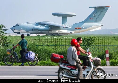

KJ-2000
KJ-2000 via Twitter
The KJ-2000 is based on IL-76. The 14-m diameter non rotating rotodome houses 3 phased array radar antennas.

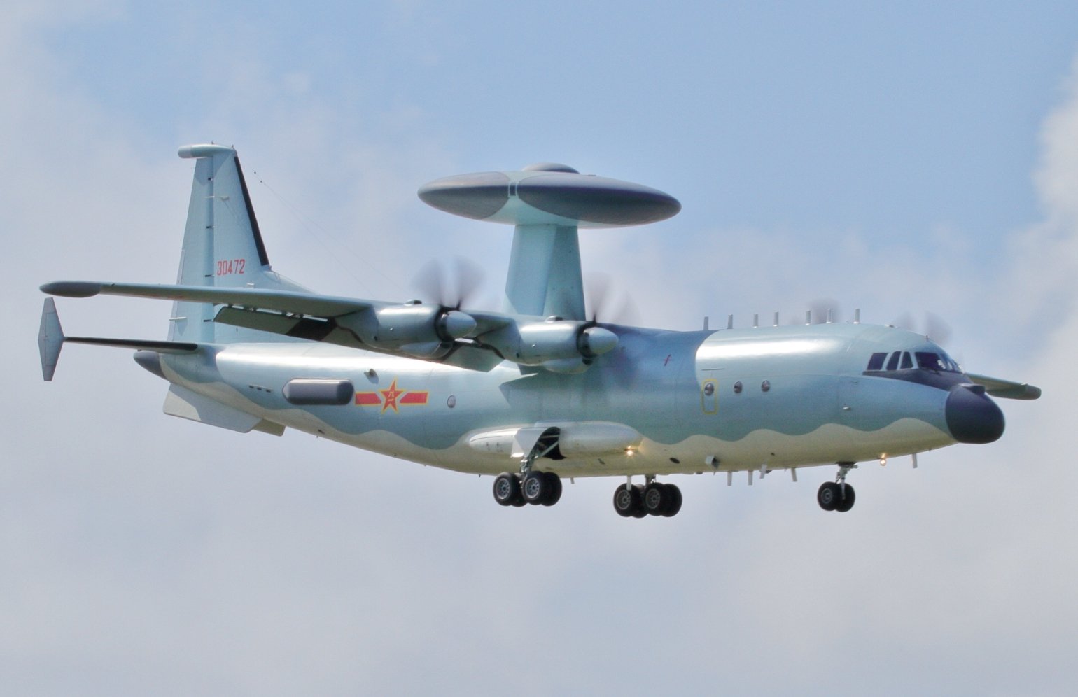

KJ-500
KJ-500 via Twitter
The Shaanxi KJ-500 is based based on the Y-9 airframe
The KJ-500 has a fixed dorsal rotodome containing three radar arrays each containing active electronically scanned array or AESA radars arranged in a triangular configuration to give full 360° coverage. The new radar design supplants the “balance beam” design used on the earlier Shaanxi KJ-200 AEW&C.
In September 2020 an upgraded variant of the KJ-500, equipped with a refueling probe was spotted in images published on the internet.
PLAAF has deployed KJ-500s to Lhasa-Gonggar Airport in Tibet.
