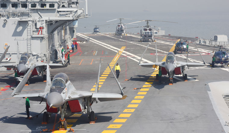

Very very big statement you made. Can you please elaborate one aircraft which has been designed to take off from carriers and especially from STOBAR carriers? NONE.
You need to design an aircraft which is perfect fit for STOBAR carriers. The TWR of Rafale-M is good for STOBAR but the wing needs to have a sweepback of 40* or less to increase the CLmax.
OR,
They must introduce BLC to the wing to go with full load from STOBAR deck. And for that they will need to put more afterburner thrust to the engines. The take off air requirement for BLC can be supplied thru the APU also. And it can all be made automatic thru software. I have flown A320s and I am in love with French for the aircraft they have made.
Well there are no aircraft designed to operate from STOBAR carriers from the ground up.
The history of ski jump carriers dates back to WW2 when the Brits had an angled deck fitted to HMS Furious for their heavy Barracuda torpedo and dive bomber. Later on, Harriers used the ski jump for assisted takeoff as their performance improved when their takeoff was helped by an angled deck.
Ski jumps were effective and cheaper to operate compared to CATOBAR carriers.
