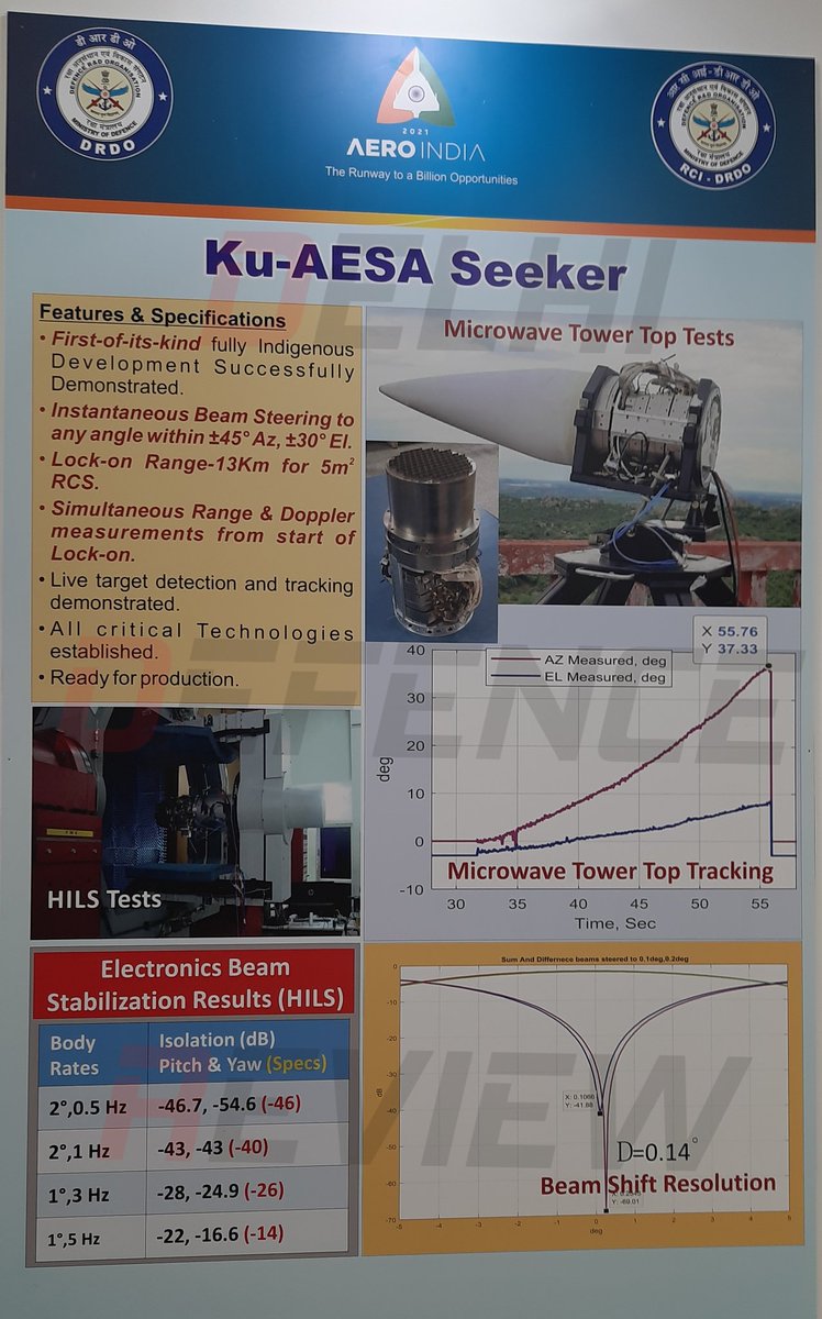

RCI was developing 2 AESA seekers. One was a Ku-band seeker, the other a X-band seeker. Both seekers were to be manufactured by Astra Microwave.
The Ku-band AESA seeker is gong in to the Akash-NG:

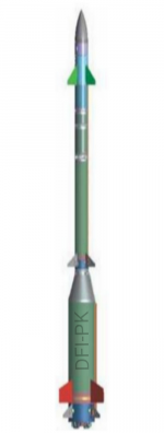

The AD-1:
And the XR-SAM:
Wonder if they are still working on this:
This missile was initially thought to be the XR-SAM. Very similar in configuration to the AD-1 & the XR-SAM but the 2nd stage uses the SFDR engines instead of the dual/multi pulse propulsion likely to be seen on the XR-SAM & AD-1
The Ku-band seeker looks a little different from the one see on this picture:
Is there another Ku-AESA seeker in the works ? Probably for Astra Mk-2.

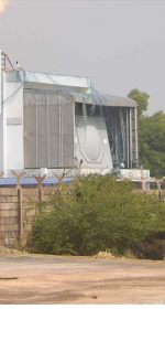

There is a radar panel under going front end integration behind the man with the turban. The panel is octagonal like the MF-STAR. But the MF-STARs are directly imported from Israel. They are not made or even assembled in India.
So this could be DRDO's LRMFR :
Thought the LRMFR shares visual similarities with the MF-STAR it is a completely Indian radar.
We saw a model of the LRMFR at the Balasore missile test facility during a Pinaka missile test. It is possible that the radar was undergoing instrumentation then. Having a live target to track is essential for calibration of new radars.
There are a number of ships being built right now that use the MF-STAR, namely the Vizag class destroyers & the Nilgiri class frigates. The Vizag class ships are in pretty advanced stage so they are definitely use the MF-STAR. But the Nilgiri class can use the LRMFR instead. The Nilgiris are not close to doing radar integration yet & by the looks of it BEL is already making the LRMFRs.
