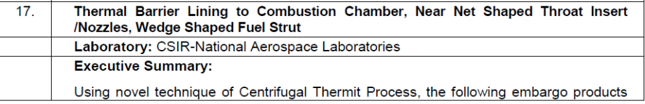

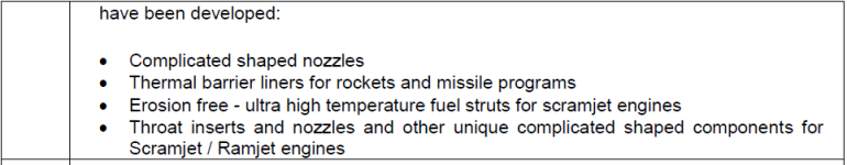

CSIR-NAL making some ram/scram jet related components that are import restricted by foreign countries.
Together with the ramjet/scramjet fuel making effort within the country, I think we are on a good stead? Special coatings are also being worked on by DMRL, long duration high heat withstanding which is already posted in this thread.
