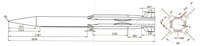

Unknown Origin Schematics of possibly the STAR missile
