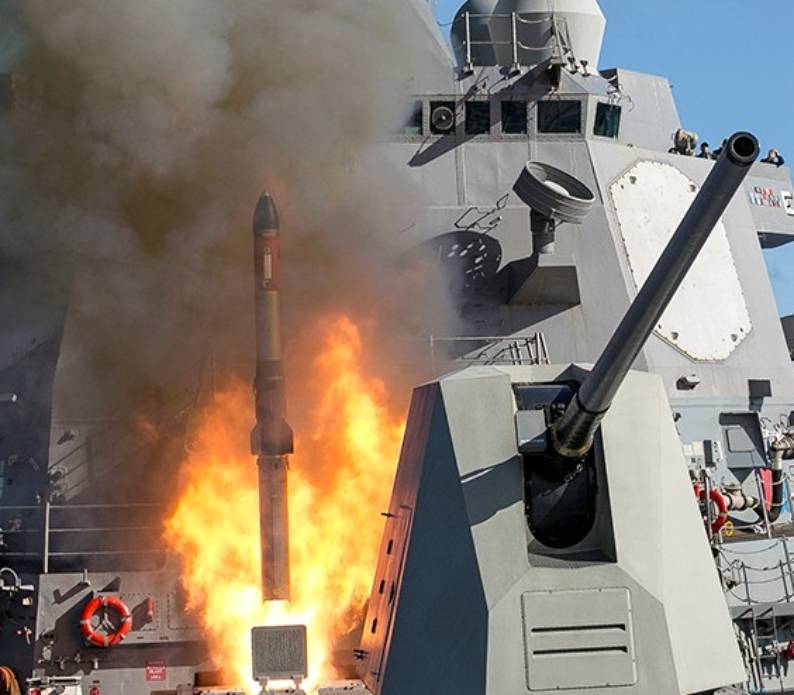

Kind of rum 139 RUM-139 VL-ASROC - Wikipedia

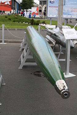

No, I am not referring that special effect in start, but from 01:14 , actually I was inquiring about whether the launch system might be like normal torpedo from ship, but some thing like supercaviation torpedo like Soviet VA-111 Shkval.
VA-111 Shkval
something like this one:
If it will be an Anti Submarine Missile, then surely it will be like RUM-139 VL-ASROC as you have stated or anti submarine version of 3M-54 Kalibr
I think Iran reportedly have a Torpedo based on VA-111 Shkval, naming 'Hoot'
Another video regarding Shkval:
Another video of Hoot:

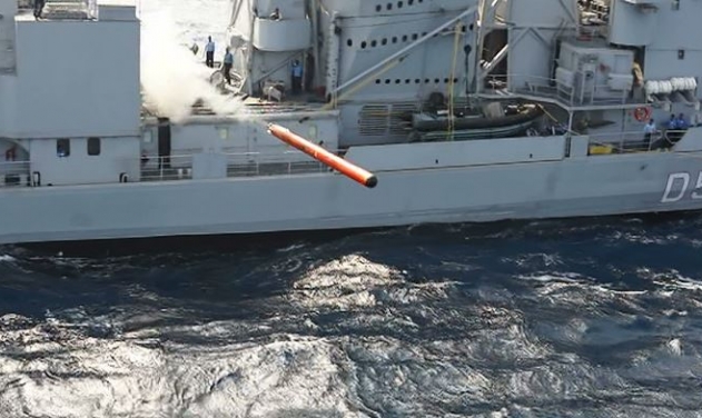

it has been fired from a surface ship. Now if the SMART be something like Shkval, then it may well also be launched from surface ship, as per wikipedia, Shkval can be launched from 533 mm Torpedo Tube.
Similarly both the Germany and the USA had prototype development but unlike Soviets/Russians and Iran they never put it into service.
Name of the German project was : Superkavitierender Unterwasserlaufkörper or Barracuda led by Diehl BGT Defense.

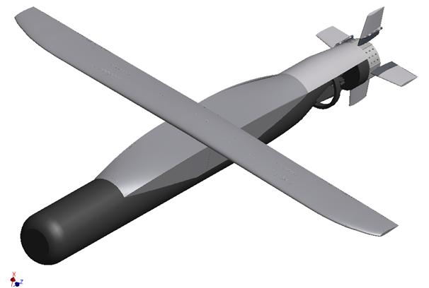

Glider Assisted Torpedo project by NSTL
Development and Implementation of control algorithm for air launched torpedo
Period : 2011-2012
The goal of this project is to develop a design of a glider configuration which when mounted on the torpedo can assist it to glide. The specified objective is to achieve a minimum range of 25 Km in a maximum duration of 250 sec when the whole assembly is launched from an altitude of 6 Km with a circular error probability of 500m. This study posed interesting problems in terms of high wing loading and development of compact mechanisms owing to the space constraints. Mechanisms are required to set the wing and tail in positions after launch, which otherwise are aligned with the torpedo and folded respectively, so that the system can fit in the bomb bay. Indigenous mechanisms are proposed to meet the requirements. Wing loading is very high resulting from the heavy weight of torpedo and geometrical constraints on design of wing. The assembly after launch has to be controlled with the help of an on-board autopilot using integrated GPS-INS so as to accommodate it in the flight envelop provided by NSTL, Visakhapatnam. Apart from glider design, this project involves evaluation of stability of the entire system during flight, trajectory simulation and performance against atmospheric disturbances.The mechanisms are developed using Autodesk Inventor software and the stress analysis on them for different loads is also carried out using the same software.
