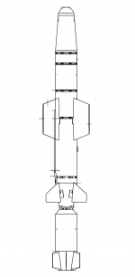

By the dimensions this missile is an analogous to the MBDA Mistral & the RBS 70, not the Igla. It is slightly bigger & heavier than both the Mistral & the RBS 70. It is going to be launched from a launch stand with the operator seated & not from the operator's shoulder. I expect the missile to have around 10-12 km range.
It seems DRDO also wants an air launched version of the missile, which will probably be the same system without the launch stand. Also they want to use it in ships. Makes sense, some our ships are armed with the Igla.
DRDO has another missile in the making which would be shoulder fired. That will probably be a smaller/thinner/lighter version of this missile with reduced range.

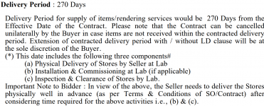

Delivery period from the tender:
270 days is ~9 months. If the vendor selection takes 2-3 months then RCI will receive the launcher in about a year from now. The missile should be ready by then. So we can expect the 1st firing trails in around October-November of 2022. Unless DRDO wants to do pop-out trials which can happen this year or early 2022.
The tender says that drawings of the launcher have been attached. I can't seem to find it. Does anybody have it ?
The drawings are not included on the public section of the website for some Limited tenders. The potential bidders are expected to email RCI to get them under NDA.
