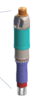

Yep, that's how OK-650B is configured on a lot of Russian boats (including Akula). The reactor itself (central cylinder in the pic) is called VM-5, the whole package (including the steam generators, pumps etc. around it as seen here) is called the OK-650B.
It is my presumption that CLWR-B2 is 'inspired' by this design. To what extent, nobody can say.
