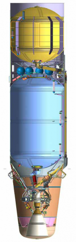

I had speculated in the past that HAL had supplied ISRO with the fuel tank for the SC-120 stage. The large tank on the right side of the slide below is probably the fuel tank of the SC-120 stage:
While upgrading from C-25 to a C-32 stage is relatively easy given both stages use the same engine, upgrading from the L-110 to SC-120 is hardly that simple. For starters we don't know if a fully assembled SCE-200 engine was hot tested yet. We know the individual components have been cold/wet/hot tested then the full engine was cold/wet tested in India. For hot testing the engine was sent to Ukraine, we haven't heard anything since. The engine was sent at least a year before the war broke out. If we haven't tested it before the war stated, I doubt we can test it now. ISRO's own test stand is still a few months from being ready & the OneWeb mission launch is coming up in 2 weeks.

Found a good render of the upcoming SC-120 stage with SCE-200 engine:
