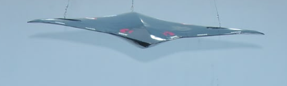

View attachment 47800View attachment 47801
Where is the 2nd image from I can't find the November 2025 newsletter which has the 2nd image, if anyone of you have this particular issue of the newsletter please do share it.
I checked with way back machine too even the 16th November 2025 archive doesn't have them.
Payload capacity- 1,100 kg
AUW- 12T
Fuel- 3,700 kg
The fuel is more than 1.5 times of lca, and with lower MTOW and no afterburner, the combat radius should be much higher compared to LCA.
It seems that Ghatak is specifically being built to drop couple of 500 kg bombs deep inside enemy territory. Hope they add mid air refueling to enable take from central bases too.

If airframe weight is 2.5T
And fuel+payload= 4,800 kg
So how AUW is 12T ?
Will it have external hardpoints ?
I hoped that it may be able to carry 2 Gaurav or 2*1000 kg Tara bombs but itd fine even if it can carry 2*500kg glide bomb
Don't forget there will be Engine, landing gears and Actuators+ Sensors+ Avionics. As much as I know it'll be capable to be operated from Aircraft Carriers too. So the landing gears will be heavier.
So approximately, Airframe = 2.5 T, Fuel = 3.7 T, Payload inside weapon bay = 1.1 T, Engine ( Dry Kaveri ) = 1 T, Landing Gears = 1 T, Sensors + Avionics+ Actuators = 2 T
Total ( 2.5 + 3.7 + 1.1 + 1 + 1 + 1.5 ) = 11.3 T or, approx. 12 T.
My calculations are not accurate, so it'll differ.

Airframe: 2.5 tons
Payload: 1.1 tons
Fuel: 3.7 tons
Engine + APU + accessories: say about 1.5 tons
Landing gear + actuators + sensors etc.: say about 2.2 tons
Adds up to a total of ~11 tons.
No as of now because it is currently a R&D/Experimental type project
I believe it would be used for testing Dry Kaveri.
