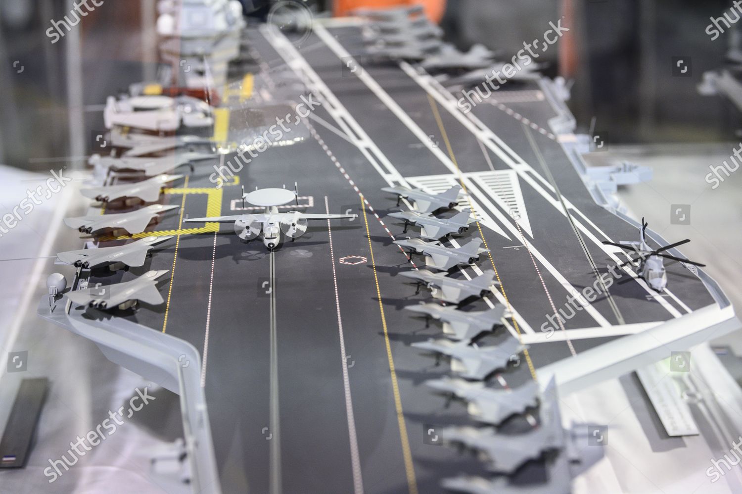

But one thing's for sure though - we need a replacement for Ka-31. The platform capabilities are too limited and the radar is frankly outdated & lacking in ECCM capabilities...not to mention more than likely the frequencies are compromised because the Chinese operate the same, making it even easier to spoof.
For IAC-2 we can look toward E-2D ourselves, but the existing STOBAR carriers cannot operate it effectively. So a common platform that features an advanced AESA radar & which can operate from both STOBAR & CATOBAR carriers would be nice to have...the ideal platform in my opinion would be an Osprey. Posted a thread on that actually, proposing a joint program with UK (they also need CROWSNEST replacement, QEC too has no catapult):
14 Ka31s are there. More or less enough for 2 carriers. Bare minimum are there. So even if additional Ka31 don't come, chances for anything else is quite low.

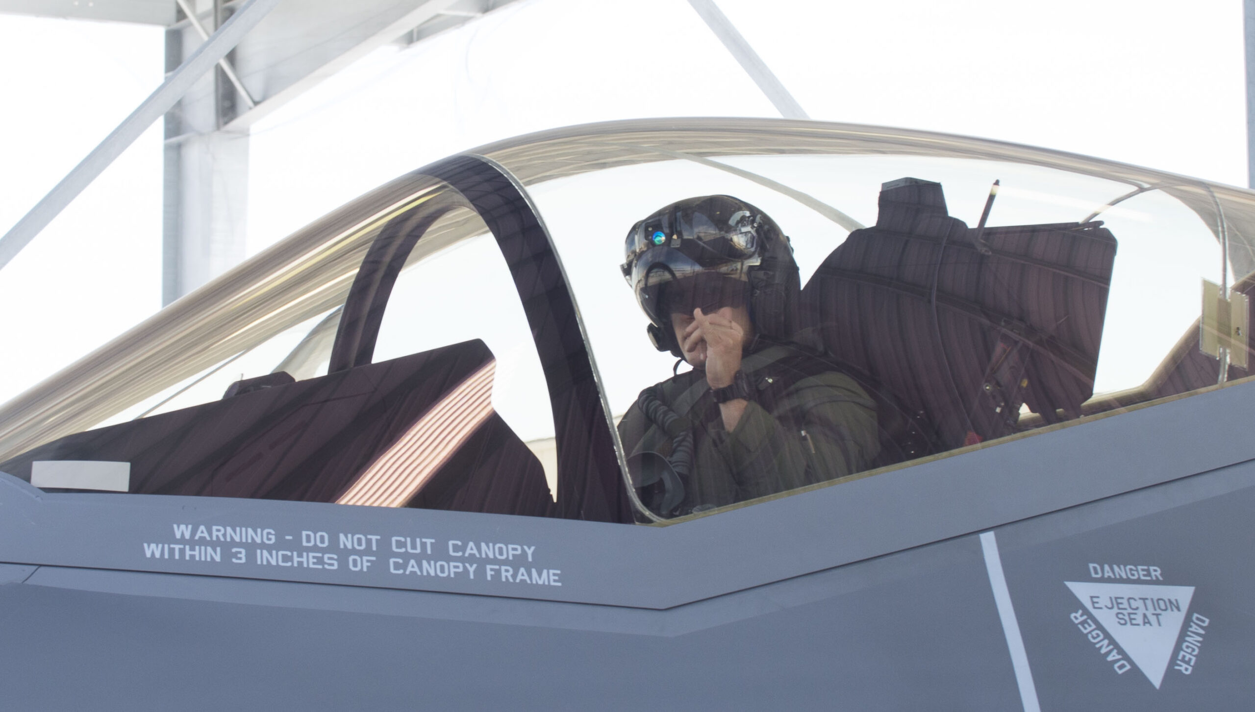

F-35 for example is only designed to operate its radar in small pings or bursts, which then serve as cues for EODAS to take over the tracking passively, minimizing the probability of intercept. VLO fighter doctrine simply doesn't allow for acting as illuminators for all warfighting elements in theatre (all of which don't have acquisition or tracking capabilities of their own) as its directly antithetical to their role as low observable attack platforms, continuously operating one's radar at full power negates it.
