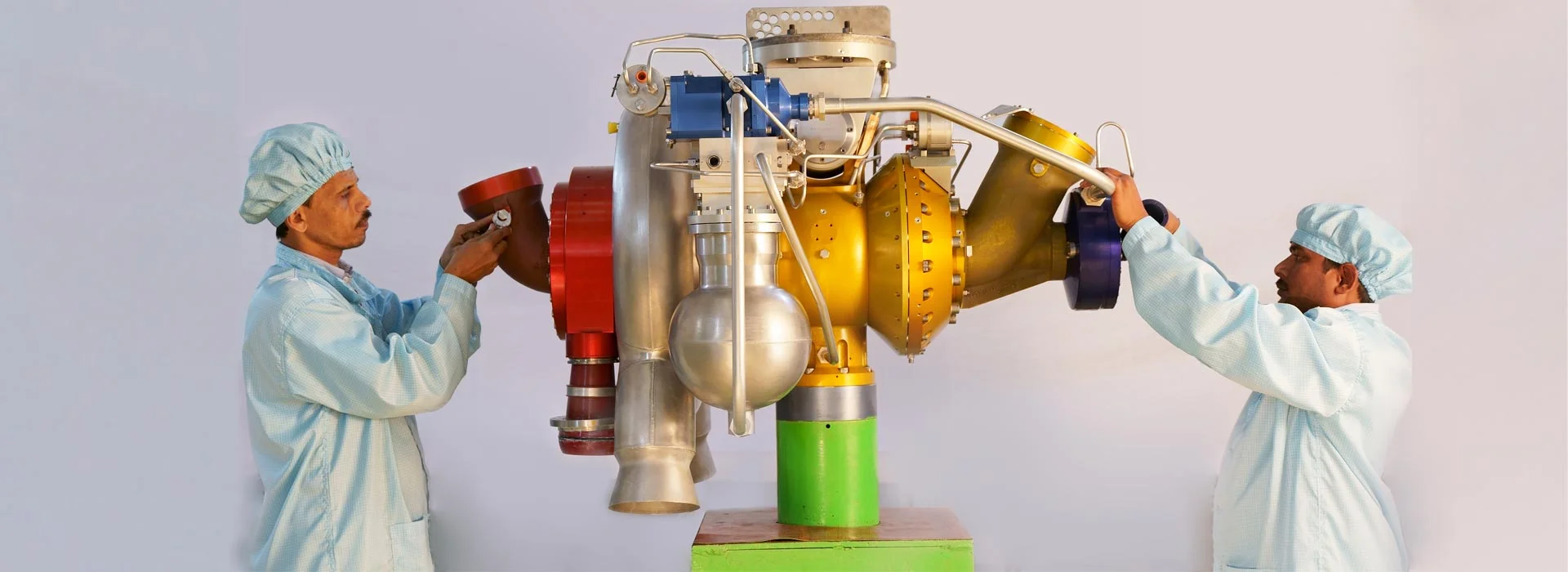

Low Pressure Oxidizer Turbopump (LPOT):
The Low-Pressure Oxidizer Turbopump (LPOT) was one of the 1st major sub-assemblies to be manufactured. This turbopump is used to feed the main turbopump with LOX. Initially the materials & manufacturing process used here were the same as those used in our cryogenic engines.
The LPOT was initially made of AISI-202, AISI-301 & AISI-316L grades of austenitic stainless steel. AISI 202 austenitic stainless-steel exhibits an impressive combination of toughness & corrosion resistance and is thus used for making impellers for driving LOX at 20 K. AISI 301 & 316L stainless steel can be hardened to tensile strengths of over 2000 MPa due to phase transformation of the unstable austenite into martensite.
Material selection/production for the LPOT was not a big challenge as LPSC could draw upon their experience of developing hydrolox engines. The problem was with the thin-walled bypass tubes that were joined using conventional welding & brazing (Look at pic above).
Austenitic stainless steels tend to have low yield strength. This wasn't a big issue for our hydrolox engines as they produce significantly less thrust & operate at significantly lower pressures. Adding to the problem was the conventional welding/brazing process used to manufacture these tubes. The conventional method was causing a higher than desirable impurity inclusion levels. These inclusions in the weld would create weak spots from where material failure would start.
To overcome these problems various commercially available precipitation hardened martensitic stainless steels with BCC structure were studied. Among the various alloys studied 14-5PH, A286, 11Cr-9Ni & 12Cr-10Ni grades were found to be suitable for our application. Subsequently domestic manufacturing for these grades of steel has been established in co-operation with MIDHANI, SAIL & DMRL.
Vacuum melting is now being used to significantly reduce the impurity levels of the alloys. Also, vacuum brazing methods have been adopted to minimize impurity inclusion during the joining process.
