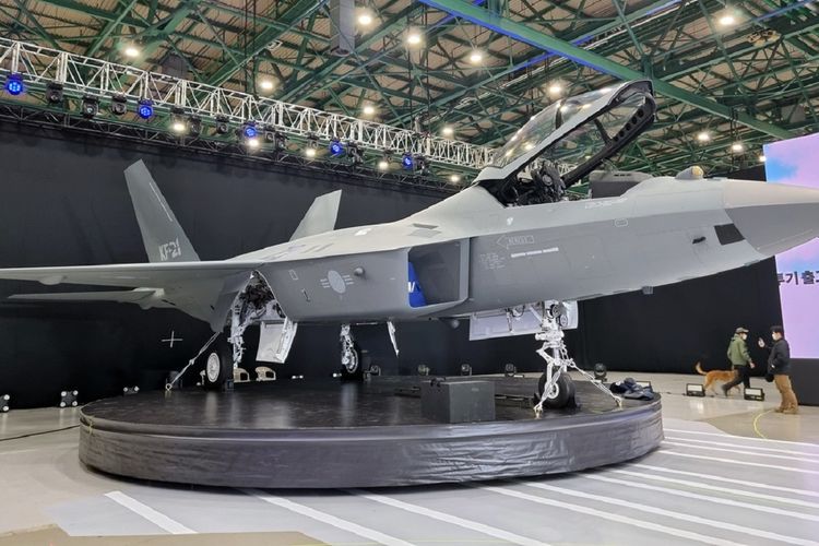

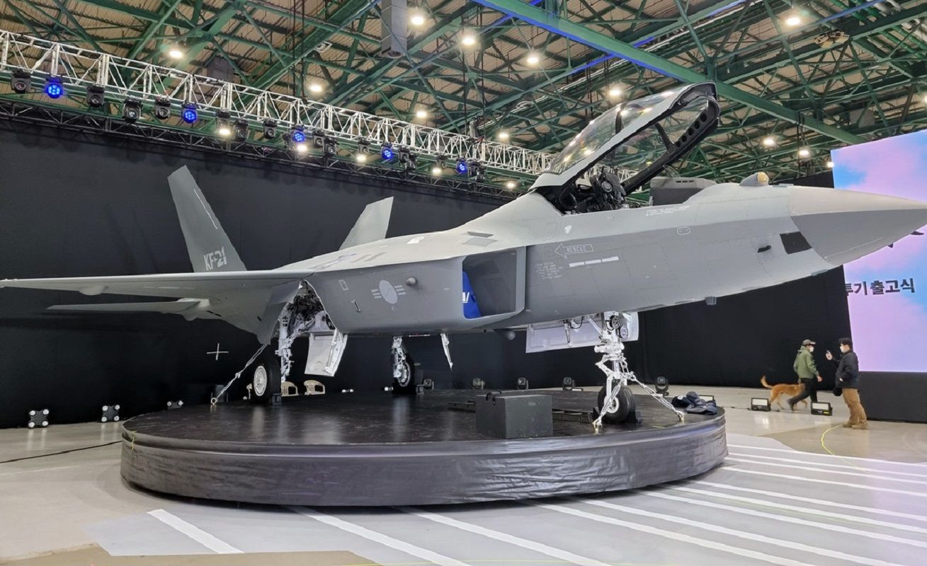

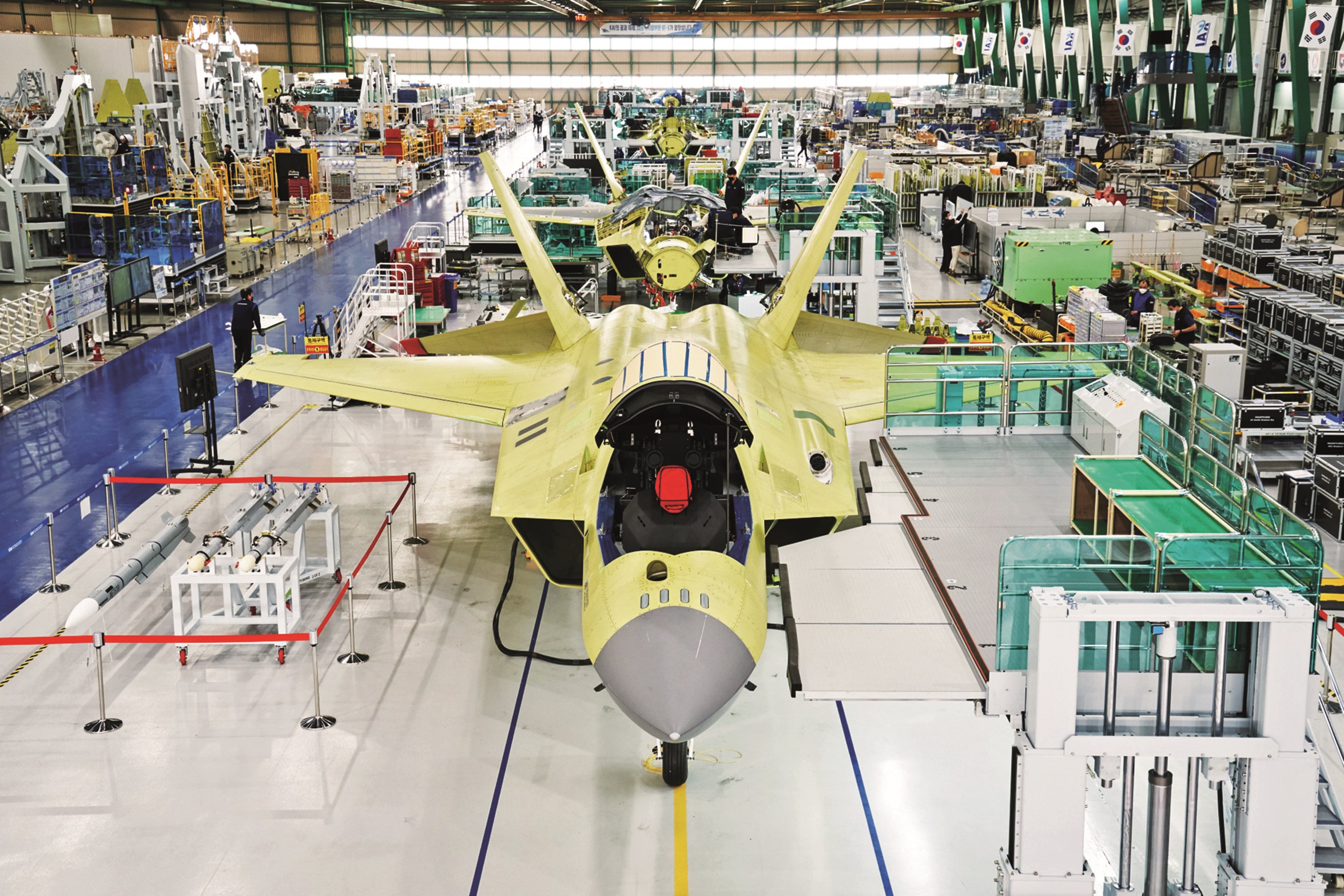

My intention was to show what it took South Korea which is a new entrant in Combat Aviation like India (although they are far ahead in terms of Industrialisation and automation), to develop a Good 4.5+ Gen fighter aircraft.
Just looking at the amount of hand holding done by US companies and the research,prototyping, testing and manufacturing infrastructure, it seems quite a lot.
I highly doubt ADA and HAL in India have such sophisticated testing and manufacturing facilities to build a 4.5 gen plane, let alone their claims of making a true 5th gen fighter jet in the category of F22 or F35.
@Gautam @randomradio what do you think where we stand right now compared to SoKo. And let’s leave the extensive involvement of US companies here.
IMO I’ve never seen such level of airframe testing being done by ADA or HAL during LCA prototype testing.
And have a look at their manufacturing assembly line video and notice the level of automation and use of industrial robots, tools used and their management. Very similar to what we seen in a Hyundai and Kia assembly plants.
There Airframe and Composite manufacturing is much more sophisticated.
Even the rivets they are using is different than what we use @Comrade Bhartiya
Compared to that HAL assembly line looks like a sweat shop with all manual work. Explains why there is so much inconsistency in built quality of LCA.

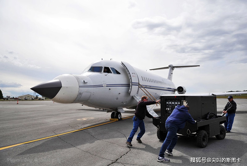

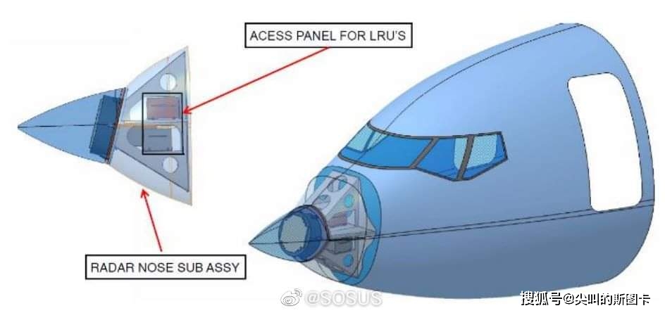

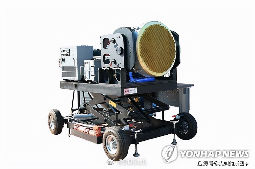

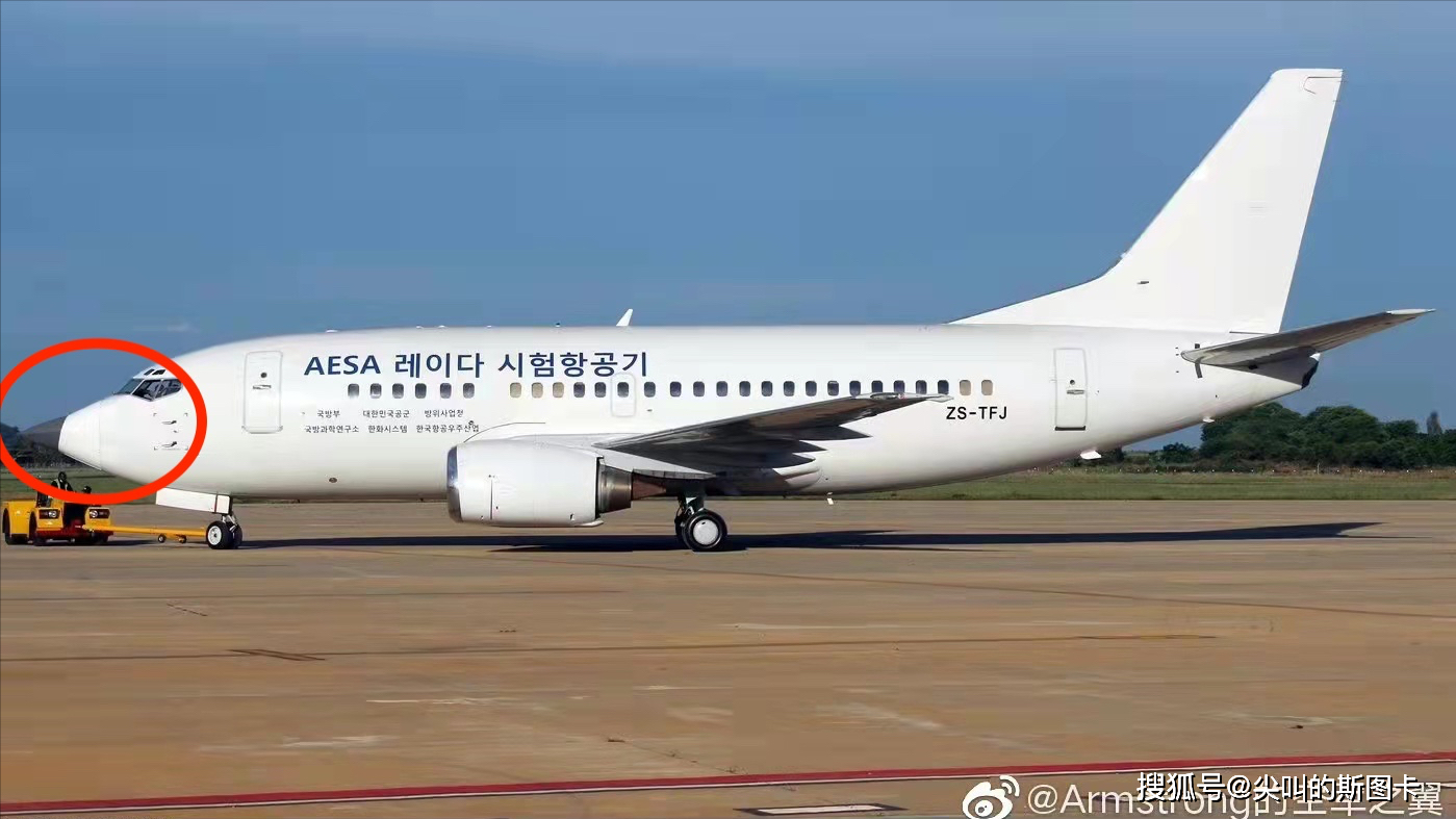

I believe those facilities have been set up with the help of and the toolings are sourced from several US and European companies like (also mentioned on the first page itself)
Curtiss-Wright

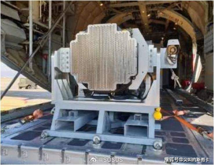

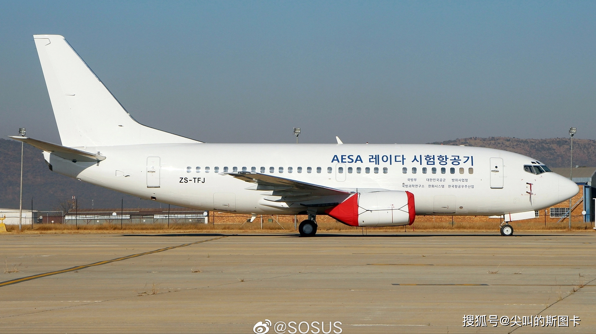

Even the AESA radar testing is being done by some South African Company.(HANSOLDT or Reutech Group perhaps)
PS: Interestingly Calspan wind tunnel test facility was where LCA testing was done during the initial design phase.
Curtiss-Wright
