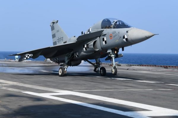

Extremely substandard article like most of Eurasian Times output.
"However, Thomas Newdick, a defense writer with The War Zone, says the chances of success of the two-seat LCA Navy prototype “must be considered extremely slim”.
Except for the above produced excerpt there's nothing in the article remotely connected to the USN rejecting the Tejas . If anything it'd be rejected ( in all probability ) for being way above the service requirements of the USN & consequently way too expensive as compared to the competition.
Reactions: Chain Smoker
LCA Trainer for the IAF has still not been certified. It's dreaming if we think it's got a chance in US.
None of the ac under competition even has an flying prototype. They has to start delivering by 2028. And none of them has an naval version. While the chance is tough, HAL should have tied up with Boeing or LM to get a better chance at a deal. While Embraer/Airbus has won US defence contract in the past, this is a huge order. 700+. It would give valuable experience and if we win it would be a huge booster. But they need to tie up with some company in US for lobbying.
Most of the participants have had actually done the thing they claim. HAL/ADA hasn't till date.
The most important thing is to actually get enough manpower and enough airframes to certify the system as soon as possible and then get that into service and then keep improving it over production blocks every 5 year atleast.
Untill this happens, we are not going to get any meaningful aircraft sales.
With the attitude we have in India we will take 10 more years to have as many aircrafts exported with atleast the final assembly done in India compared to what Pakistan already has. We are a joke. Accept that, untill we do, we do not work on the problem.

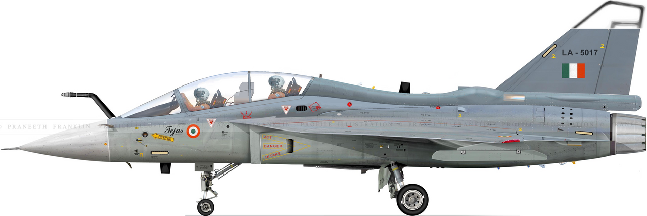

Most of the participants have done what here ? If you're referring to their past track record it doesn't amount to much as far as HAL goes for unlike the others HAL already has a product which flies & only needs modifications for this project. Perhaps HAL needs to check if it needs US certification in this regard.
Further , I've just noticed one of the requirements of USN is for the said aircraft to "touch & go " off Aircraft Carriers. I wonder if the NLCA is not a better fit here as compared to the SPORT LIFT version of the LCA Tejas.
