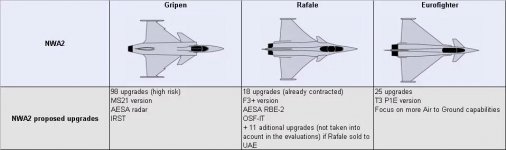

The points table published by the Swiss is for the NWA2, meaning the paper capabilities expected to be operational in 2015. So the points table likely considers Typhoon has full data fusion, similar in capability to the Rafale, since even I've assumed Tranche 3 and beyond have IMA. But such a Typhoon did not exist when the evals happened. For NWA1, the Swiss claim the Typhoon is deficient, although they don't reveal the true deficiencies. Regardless it's understood NWA2 is not reflective of Typhoon's actual capabilities, which are yet to be met even today.

No, that table was for current capabilities at the time. How the f*ck could you assume that both aircraft would have whatever and then appoint them a score that puts one ahead of the other? You need to take the little French cock out of your ear and learn to think by yourself.
Nope. NWA1 is for current capabilities, as of 2008. NWA2 is for capabilties in 2015 that the Swiss would induct.

Nope, the chart was for current capabilities, otherwise I'm sure the French would have leaked the NWA1 evaluation since it would show them more favourably. If it was for soon to be capabilities, then how the hell would RBE2-AA be rated higher than Captor-E for detection? All garbage, all from France, all from the dick in your ear.

Clearly says NWA Phase II.
Ie, a fictional Typhoon configuration against a real Rafale configuration, since the Rafale's upgrades for the Swiss were already contracted by then.

Right so basically it didn't include Captor-E, because that couldn't be demonstrated in 2008, so you're saying that Captor-M still beat RBE2-AA on engagement? Always said RBE2-AA was a poorly and hastily developed AESA for marketing. It was still testing what could be demonstrated at the time so T3 P1E version, as demonstrated, was only just behind the F3+ on SA. Same argument applies really, the Rafale is nowhere near F-35 level.

Right so basically it didn't include Captor-E, because that couldn't be demonstrated in 2008, so you're saying that Captor-M still beat RBE2-AA on engagement? It was still testing what could be demonstrated at the time so T3 P1E version, as demonstrated, was only just behind the F3+ on SA. Same argument applies really.
What makes you say that? I'm more inclined to believe the engagement category has a lot to do with the BVR missile, where the AIM-120 outperforms the MICA in a straight-up fight. There are other categories which involve the radar, like detection, acquition and identification, where the AESA gives it a significant lead even in Air Policing. So engagement obviously involves the literal concept of engaging the target with a weapon, since that's what comes after acquisition of a target.
