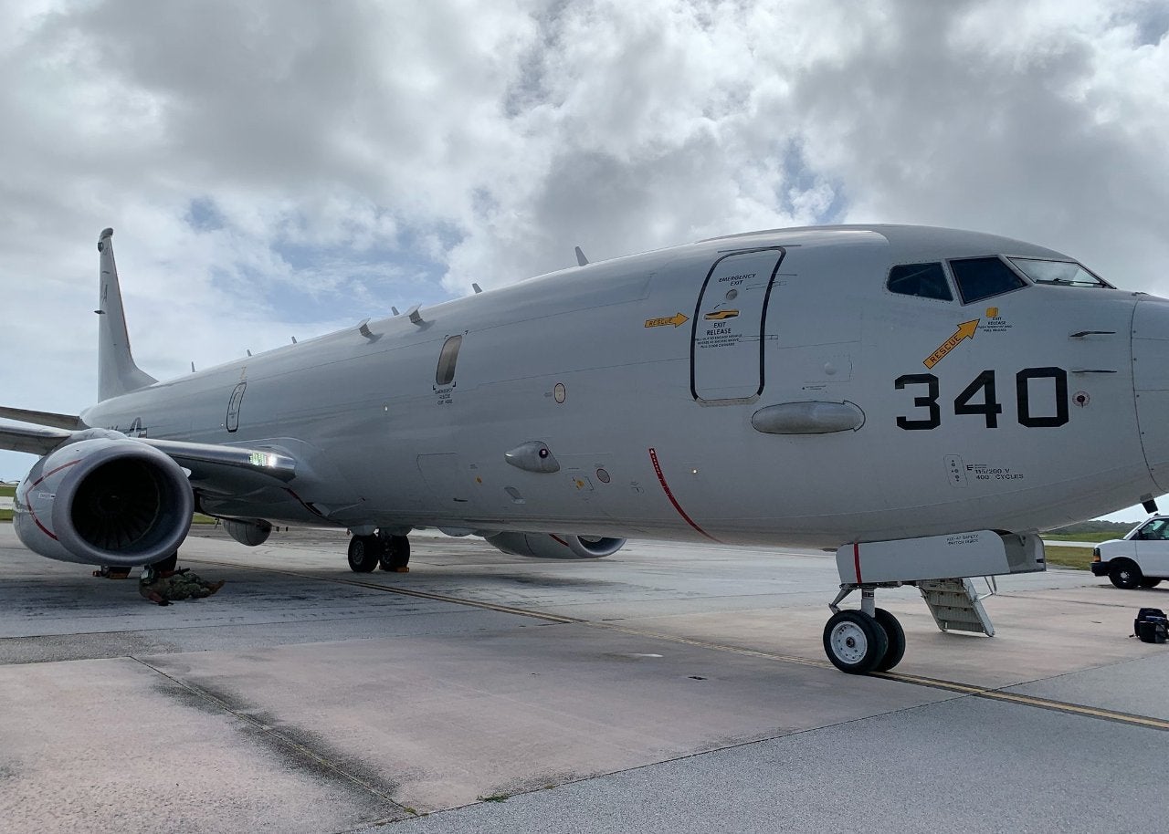

Indian Navy P8 I in GUAM
ASW exercise

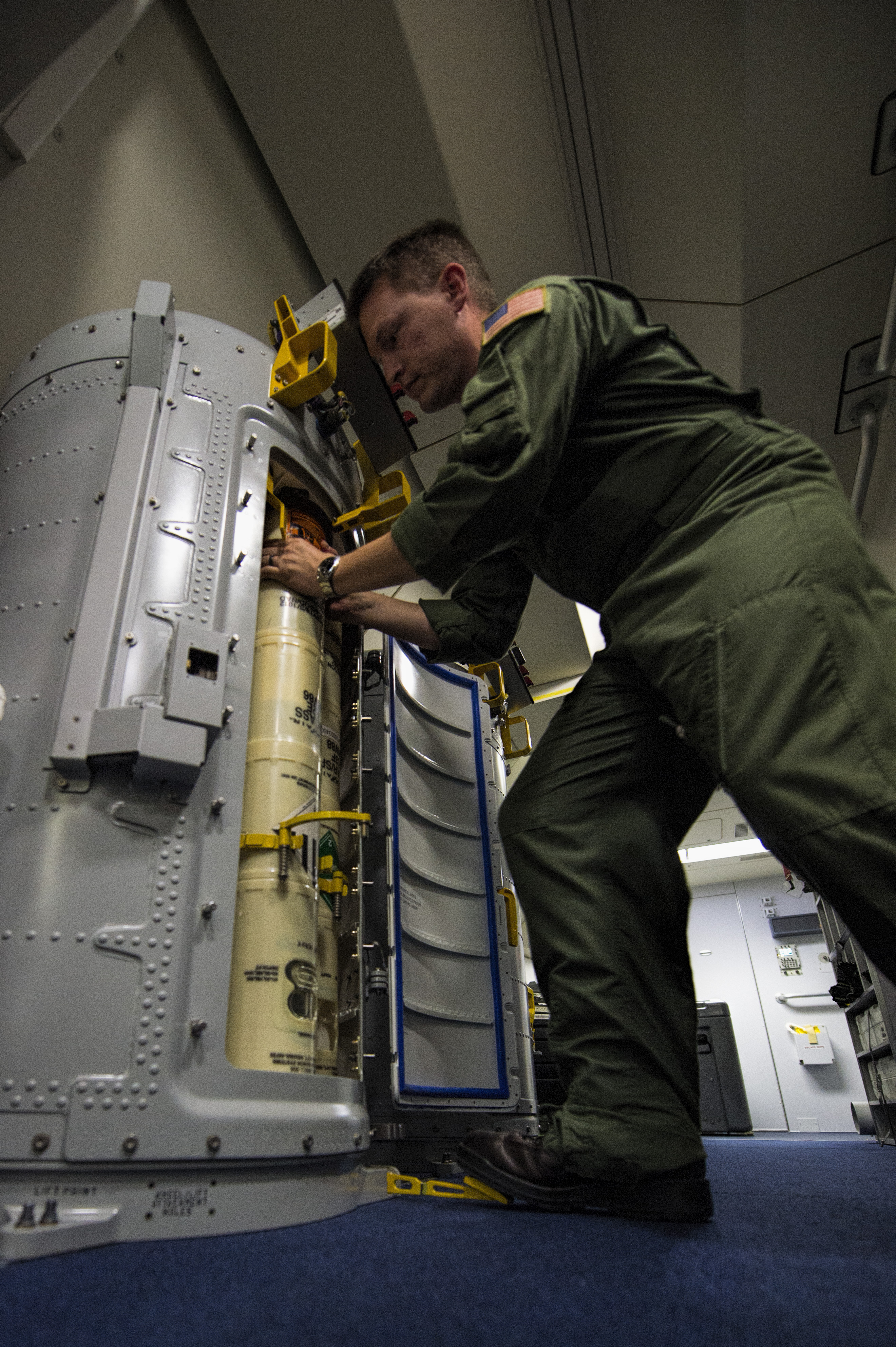

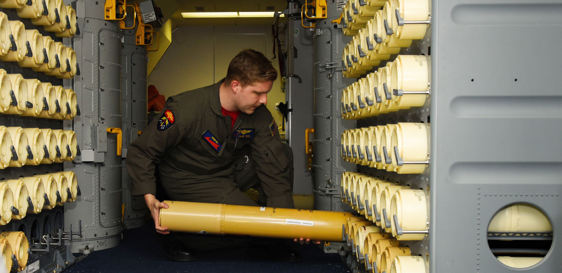

Umm...in addition to those multi-spectral cameras the P-8s have:
A large number of Sonobuoys:
In storage:
In launcher:

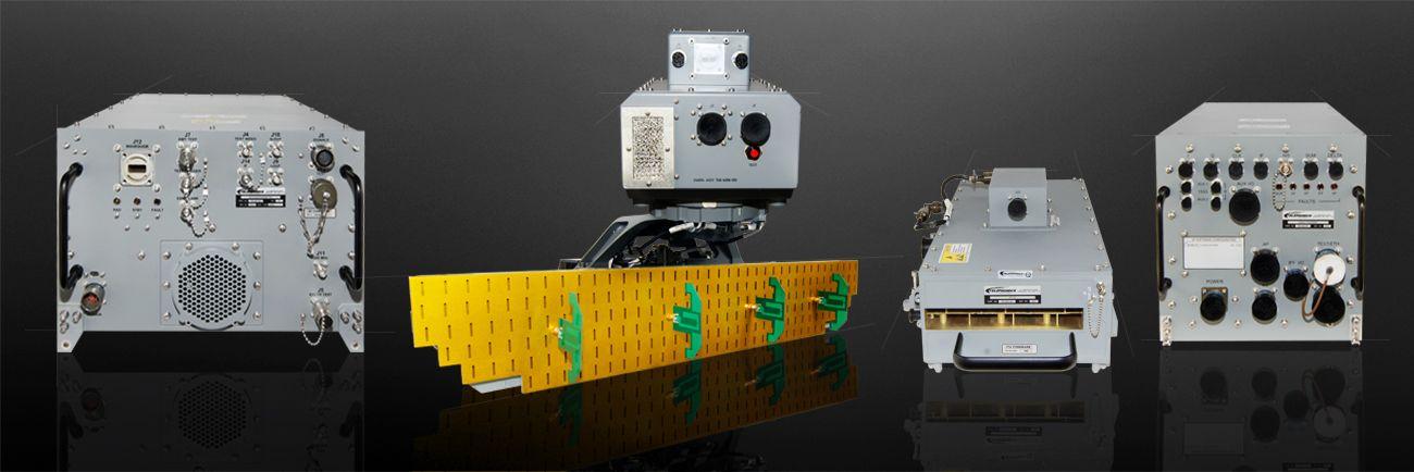

A pair of advanced radars (front & back) that are sensitive enough to detect even a periscope or snorkel mast above the water:
AN/APY-10:
AN/APS-143(v)3 OceanEye (unique to Indian P-8I:
