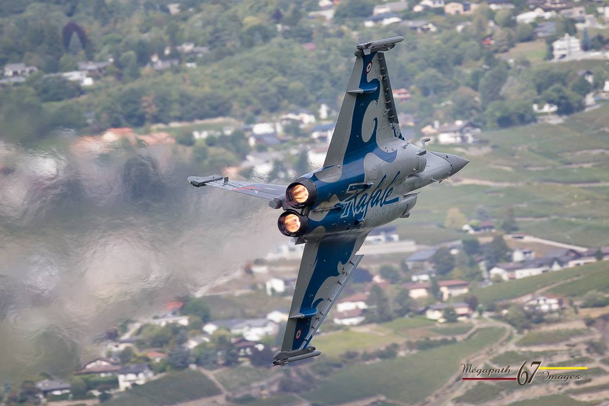

100kt Stall? Rafale proved to be able to stay maneuvrable at far far less speed....
Sadly using Picdelamirand-oil 80kt +wod numbers. You may be right with the minus -40kt, after taking off and going backwards, tail first into the water.
Google said " Launch and recovery of aircraft, A Rafale fighter jet makes a catapult launch on the flight deck, where in two seconds the jet goes from 0 to 250 kms per hour, aboard France's flagship Charles de Gaulle aircraft carrier March 28, 2011."
My maths say that 250kmh is 135 kts plus WOD. 80kt is only 55kts slower.

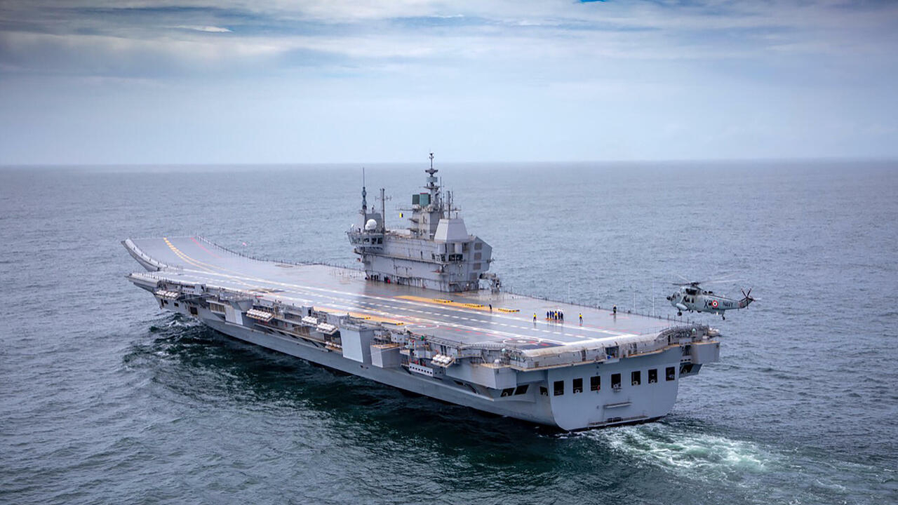

France, US tussle to sell fighter jets for India's homemade aircraft carrier​
French aircraft manufacturer Dassault Aviation has offered to equip India’s homemade aircraft carrier with Rafale jets. But the French firm faces stiff competition from America's Boeing, which is pitching F-18 fighter planes for the new vessel.
India this week commissioned the 43,000-ton INS Vikrant. The giant vessel can hold 30 aircraft and helicopters – about half the capacity of the US Navy’s Nimitz class carriers.
Vikrant will initially be equipped with Russian-origin MiG-29s borrowed from India’s other aircraft carrier INS Vikramaditya. Vikrant will then rearm with Western aircraft once the deal has been approved by the government.
"As of now, there is no one else in the race except Boeing and Dassault,” one official told RFI of India’s four-year quest for 57 dual-role combat jets for its two aircraft carriers.
India bought 45 MiG-29s in installments starting 2011 and, nine years later, it cleared the import of 21 additional units and ordered the modernisation of 59 of the multi-role jets.
The trouble with MiGs​
Captain Rajat Kumar, who leads INS Vikrant’s air wing, has reservations about the MiG-29s that will come on board his carrier, powered by four gas turbines that can pump out 88 megawatts of power.
“The MiG-29 is a large aircraft – it was designed by the Russians and it is quite challenging to land on a deck,” Kumar told media on board the new carrier that cost 2.52b euros and took 20 years to build.
National auditors have said the ageing MiGs suffer from engine failures and other “operational deficiencies”.
Military officials told RFI that 26 Western jets would eventually operate from the 860-foot long INS Vikrant, which will commence flight tests in November and continue until mid-2023.

Flying at 100° AoA or -40kt is never made at 100 feet....
And it was just to show how the fly by wire is mastered by Dassault.
The Cobra figure for exemple is absolutely of a no use in real combat : you are a perfect slow moving target in the sky, so a perfect target for a WVR missile or a skilled gun fire.

Rafale 'too slow' stall speed is 100kt, A2A configuration. Heavier is more drag, less lift. There has to be a safe air speed buffer and I doubt it be 80kt deck speed and 27kt WOD. WOD is also not fixed and is affected by true wind speed and direction.

Rafale HUD 100kt 'too slow' stall warning, as pointed out by Ats

I have been going thru this thread for sometime and so need to put certain things in proper perspective.
The WOD required for launch performance is the maximum speed the ship can attain this ensures that even in zero wind conditions, the limiting WOD is available for Launch. Like for Indian navy, it is 28 kts.
The calculations shared by @pic-del-amirand were correct.
The aircraft when launched is never restricted to its stall speed but a speed which is about 15% higher than the stall speed for the given configuration called the Take Off safety speed. There is a difference between clean power off stall speed and clean power on stall speed and with increase in load it goes up.
The launch performnace of a twin engined fighter is not calcaulated with both engines operating but with one engine failing during launch and that live engine pushig the aircraft to the take off safety speed. For this we assume that all external loads are jettisoned from the aircraft within 2 seconds of engine failure and its take off configuration w.r.t falps/slats and undercart are undisturbed or the undercart is in the process of being retracted.
This speed is further restricted by the limits of rolling and pitching of the ship as during launch, the deck may actually being pitching down and this parameter for IN is 2*+/- and 3* in roll. So your exit angle maybe anything from 12* to 16* at the top of skiramp as the skiramp angle is 14*.
When the aircraft goes on the ramp, we assume that the accelaration is maintained and it happens also as we talk of velocity. But the load increase on the wheels causes the oleos to compress further and after launch, the wheels suddenly extend downwards which require restrainers which you must have seen in N-LCA as well. When we take off from ground, the pressure from the oleos is released in a gradual manner but it is opposite of it when you do a Ski Ramp launch. The pilots can undergo upto 2Gs while going off the ramp as you go up in a circular motion over the ramp.
In a CAT launch, we assume a height loss of 10 feet as the aircraft transitions from ground effect to non ground effect after exiting the deck but Indian Navy has a restriction that the take off safety speed must be achieved without loss of height. Which means, the aircraft must reach the take off safety speed by the time it reaches the top of launch trajectory. But Chinese allow for aircraft to drop back to the exit height to recover. This restriction of Indian Navy halves the time available for accelaration and that has resulted in reducing the load carried by the aircraft. This has probably come from Sea Harriers wherein we were supposed to transition out to nozzles fully aft with a residual rate of climb of 200 feet/minute. At exit we used to hit about 800ft/minute climb rate which used to reduce as we used to nozzle out and we used to exit the ramp and hit 18* bar on HUD.
For landing performance, Indian Navy has put a limit of WOD of 20 kts. Why so, is beyond me and I even questioned them and they were not able to answer it. If a ship can generate 28 kts WOD in nil wind conditions, it can do so for landing as well.
The landing performance is always calculated for the worst case scenerio which results in highest landing speed and that is usually for the failure of Flaps/slats or other control problems. Plus the loads are what is called the minimum bring back load as we have limited ammo onbaord the ship and we can't keep dumping them at sea to save the aircraft.
Once again the landing speed as calculated for landing on deck is diiferent from how it is calculated over land. We use a speed called Vps=velocity poweron stall at 1G for any given configuration and this peed is lower than the speed for landing on shore. The shore landing speed is Vs1g= velocity stall at 1G condition. This speed is increased by a multiple 1.05 to arrive at approach speed. Plus we have 3.5* glide slope on the carrier approach while it can be 2.5-3.25* for shore. This higher glide slope angle increase the rate of descent, reduces the power requirement for approach and as a result the componant of thrust adding to the lift, given by the formula T x sin x alpha. The touchdown speed and loads on the each gear are calculated based on the this speed with an addtional 2 kts for the accelaration which the aicraft will achieve when it opens max thrust prior to wire engagement and touch down.

In high sea state, we always sail the ship 90* to the waves so winds are always head on. Ships have much better sea control in pitching than in rolling. Incase of gusting winds, the lowest value is used as the WOD for launch parameters calculation. We man the aircraft and do our checks and start up and the launch time is announced, just prior to launch, the carrier and the screen change station to Foxcorpn or flying course and launch is cleared. The launch course is given to the pilot before launch and he feeds those parameters to his flight management system/ Mission computers plus the aircraft gyros are aligned with ships gyros and the PPS=present and future position of the ship is given.
