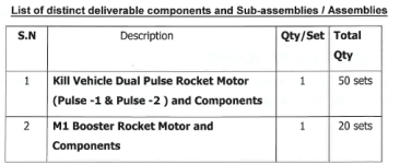

FWIW, all the running tenders of this have been extended till 16-17 November, possibly due to shipping/import issues maybe. Airframes, control surfaces & wing assy, LRSAM kill vehicle, booster motor for M1, canister, REMA-K for M1. Could be paused, cancelled or re tendered later. many things play part. :cautious:

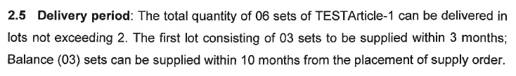

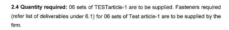

They have upped a test article sow, which is in similar timeframe as to the BDL also having the 3 LR/MRSAM systems tender. So maybe those are related. DRDL termed as test article, 6 nos, first lot 3nos to be delivered within 90 days. So maybe a test will happen in near future.
