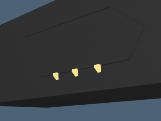

The main bays are 4.5m long, 0.7m deep and 1.2m wide. The side bays are 4m long, 0.5m deep and 0.8m wide. The main bay allows carriage of 2xmeteor and 2xASRAAM in staggard manner. The two side bays can carry 2xMeteor each. I have kept the design LO and not gone for VLO to provide for 2xASRAAM on wingtips. The wingtips of the design can be easily replaced to achieve VLO design on line flying.
I thought you planned on having 4 independent smaller side bays rather than 2. But having 2 does save up on all that extra weight.
Will 4.5m give you enough clearance for placing the K-77M in tandem?

I can increase the main bay length by 20cms very easily. But anything beyond that will make things very difficult. However reducing the sidebay length will make things very simple for me from undercart retraction consideration.
Modifying the side bays will be much more intersting. Even without touching the main bays, you can increase the missile load to 8 missiles. Or even the standard 4 BVRs and 2 WVRs in the side bays, leaving the main bays for heavier stuff.
The problem with side bays is with the missile placed higher. It will hit the loads on inner most pylon while being ejected. So it will be ejected at a steeper angle compared to the lower missile. This change in the angle of ejection requires higher clearance between the two side bay missiles. Otherwise I can easily fit three of them in each side bay.

They add to the drag and also RCS. I am of the opinion that we must fire an IR WVRAAM only in LOBL mode. In a large force merge, LOAL mode can result in shooting down own aircraft as well. For LOBL mode it is impostant that the seeker is locked before firing and for that its head must be exposed to look for targets. Such thing will not be available if IR WVRAAMs are carried in internal bays. Moreover, there is always a chance for snap shoot. You sometimes pick up a target very late and in such situations even fraction of a second is crucial. A missile carried externally can be fired in a much shorter time compared to the one carried in the internal bays for obvious reasons.
Missile can discriminate unless stupid.
Thank you! Many forumers around the world forgot about the interest of LOBL vs LOAL (specially F-35 fanboys community)
This comment worries me. If the IRST of your missile can't discriminate between friendly and enemy aircraft, then can the IRST on the Rafale?
