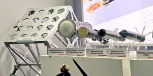

Bhargavastra's ground version has it's own standalone EOIR/FCR mounted on the truck. On a ship, it's possible we can integrate it with the ship's EO/radar systems for guidance but if it turns out a co-located fire control system is best for anti-drone launches, then a swivel mount will be optimal.

Bhargavastra is very tiny. If it fits in the back of a truck in 8x8 config, then the space it needs is practically nothing on a ship.
It's probably the same size as an ATGM.

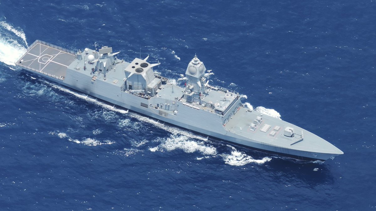

Regardless, there's many more spots for a trainable mount as you only have to worry about above-deck space. For a VLS, you have to worry about both above-deck & below-deck space. So the number of options will inherently be fewer. No way around it.
Our ship designs have more space below deck, not on the deck. In fact, we could only install 2 CIWS on our frigates.
