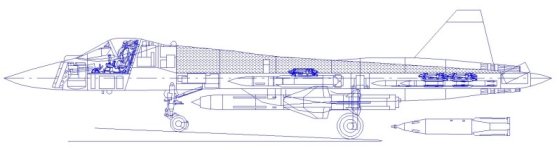

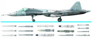

Russia's Su-57 also has fin folding weapons like -
- Kh/X-59 Mk2 CrM
- Kh-69 CrM
- Kh-35E AShM
- Kh-38M & Grom-E1 AShM
- Kh-58 UShKE ARM
Whether Russia will make Naval Su-57 or not, it has demonstrated fundamentally or notionally that a Naval stealth Su-33 sized jet can be made with naval strike weapons. Ultimately something which can operate from Russian carriers will replace MiG-29 & Su-33.

- all types of platforms & weapons are made w.r.t. size, range, speed, guidance, payload, fuel, performance, etc.
- New types of targets can come up any time. The jet design should anticipate future threats & upgrades in its scope.
- Many weapons are made commonly for army &/or navy &/or AF. This affects aircraft design.
- sword/shield both aspects develop with time. No threat discount to naval jets.
- ideally a 5/5.5gen jet would sneak & destroy 4/4.5gen jet before the later detects former. The last thing they'll hear is RWR/MAWS beeps. So 4.5gen jets if put on frontline, may become source of security breach.
- Brahmos, Kinzal kind of BIG AGMs cannot become criteria to negate future stealth naval fighter bcoz there are so many aspects & use cases of a combat jet. Otherwise India will never ever get stealth naval jet till eternity. 🤦‍♂️ :ROFLMAO:
- Moreover, Brahmos is about high stand-off range, while stealth enables to sneak closer, hence a smaller AGM with shorter range suffice.
> But still, tehnically, a Su-33 sized stealth naval jet can carry Brahmos type weapon on centerline, with special retractable attachments not compromising stealth after launch. The following drawing is made by Russian guy with username "paralay" on other forums.
If mechanical engineers can make a 50% bigger jet with bigger strong landing gears & longer AC then BIG weapons can be carried internally.
So a stealth naval jet with 8 AAMs + Brahmos is technically possible but may not be feasible.
