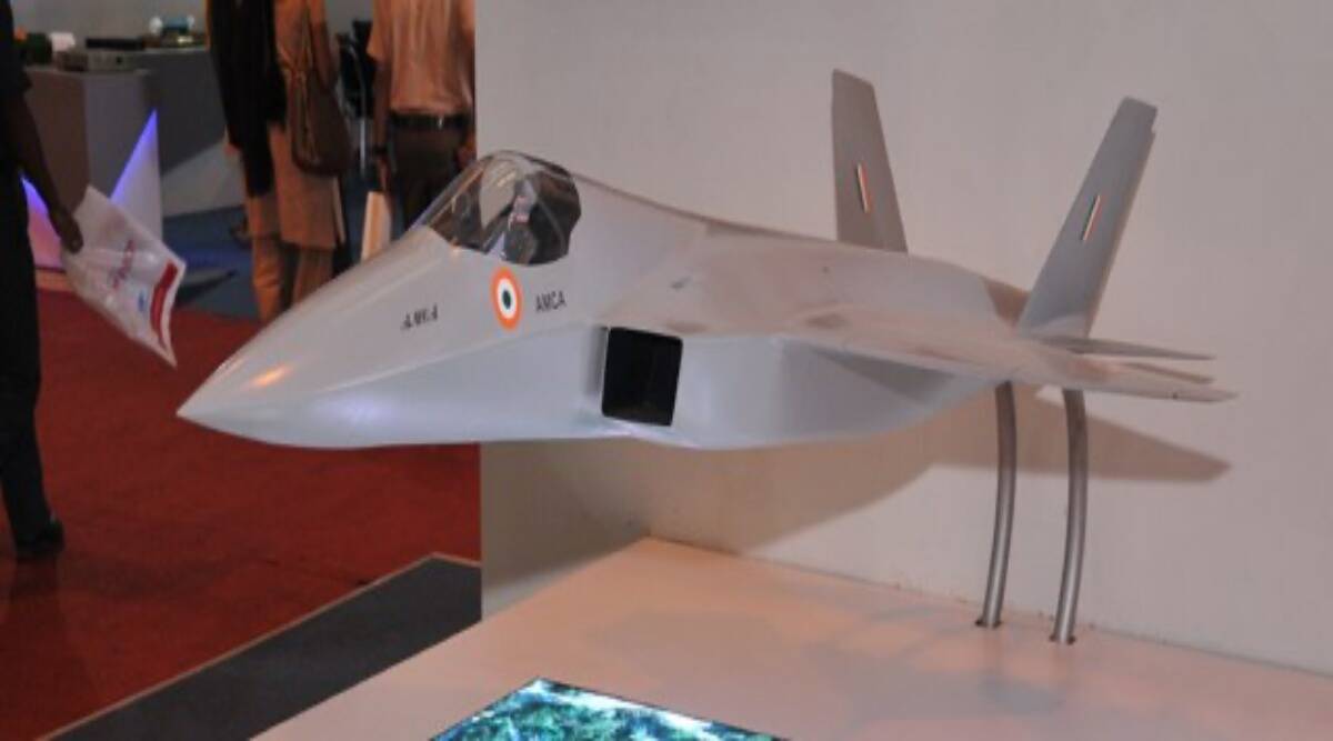

Could be DAS as well as per certain posts in the thread.
I think they are testing fixed-DAS(MAWS), not EOTS which requires moving gimbals for laser designator & single target track.
This obviously is not at all the optimal stealth shape of EOTS. This arrangement is only for test aircraft.
A DAS sensor is combo of MAWS & fixed IRST by digital image processing, it can be called as POSA (Passive Optically Scanned Array).

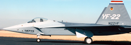

This was not the case in YF-22 where gear retracted forward
