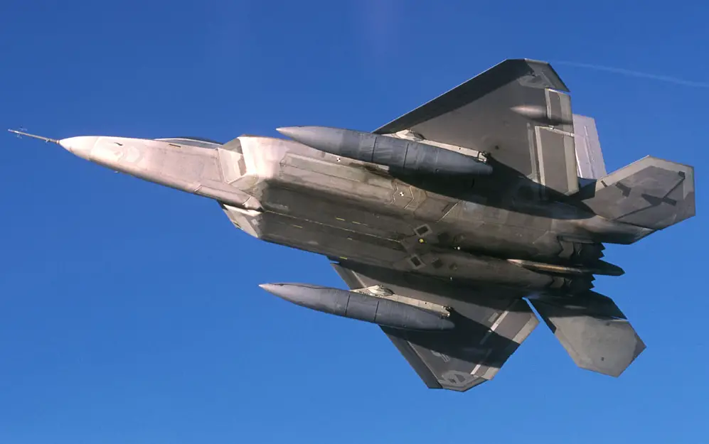

That is why internal carriage of stores is such a big deal. Missiles & drop tanks were not designed to be low observable. It's like carrying a Luneberg lens into combat.
A Rafale with 2 x AAMs on the fuselage stations will be able to look & shoot first against a Rafale with 6 x AAMs on its wing stations & 2 x drop tanks. A Rafale with a clean load will be able to look first against a Rafale with 2 x AAMs on fuselage stations. It just can't shoot first cuz it has no weapons.
An AMCA with 4 x AAMs in internal bays will be able to look & shoot first against anything that's carrying stores externally.
You are underestimating just how huge the drop in RCS is going to be compared to a non-LO aircraft, in a combat config. And that's not just because of the airframe shaping, DSI & trapezoidal wings, we're working on advanced RAM coatings for the bird as well.
Forget Rafale, if an F-22 shows up with it's transit tanks out like this, AMCA will look & shoot it first:
AMCA may not be VLO in all-aspect, but it is virtually guaranteed to have a considerably lower RCS than Rafale in any imaginable aspect.

Not a trade-off, it's the reality of stealth jet operations. Even F-22 suffers from this.
It's still a far stealthier solution than carrying stores externally - that's the point.
That makes it a trade-off. So the AMCA/F-22 are vulnerable with exposed bays, but the Rafale isn't 'cause it's in stealth mode even when firing away missiles, 'cause it knows its RCS even post changes in external stores.
