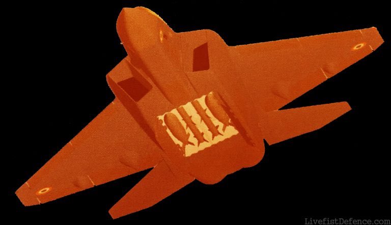

The clean weight includes the IWB load. The internal fuel figure is around 6tons.
The DRDO Chief had pointed out earlier than the internal fuel will be 6.5T. But clean load generally means without weapons.
If we assume it's 6.5T for fuel, then the internal weapons load will be 1.5T. But that puts it in the same class as the Rafale, at 25T MTOW. If that's the case, then it's just a smaller version of the F-22. Even though officials said the MTOW will be much closer to 30T.

This old presentation from Chief Saraswat put AMCA's normal takeoff weight, whatever that means, at 18.5T and internal fuel at 6.5T. The empty weight seems to be 11T, can't make out, perhaps 10T, perhaps 12T. Internal carriage is only 1.5T in this.
So I suppose we are back to medium weight category.
Empty = 12T
Fuel = 6.5T
Internal load = 1.5T
External load = 5T
MTOW = 25T
Total thrust = 220KN
