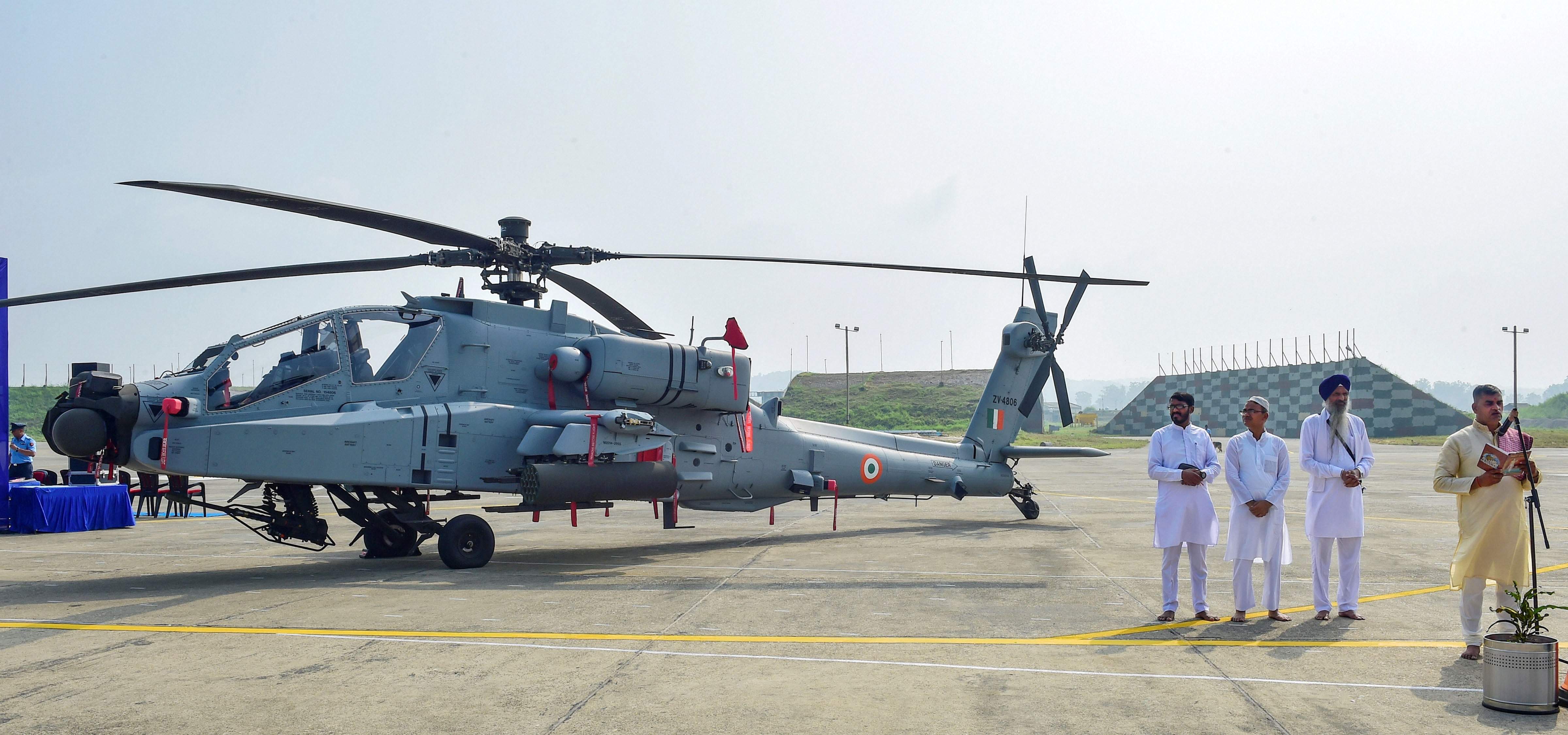

Newly-inducted IAF helicopters 'Apache' perform during the 87th Indian Air Force Day celebrations at Hindon Airbase in Ghaziabad. (Photo | Parveen Negi, EPS)

Eight units of the US-made combat helicopter Apache AH64E (I) -- where 'I' stands for India-specific enhancements -- were inducted into the 25 Squadron of the IAF in Pathankot in September. India has entered into a multi-billion contract with US aviation major Boeing in September 2015 for acquiring 22 Apache choppers in flyaway condition.
