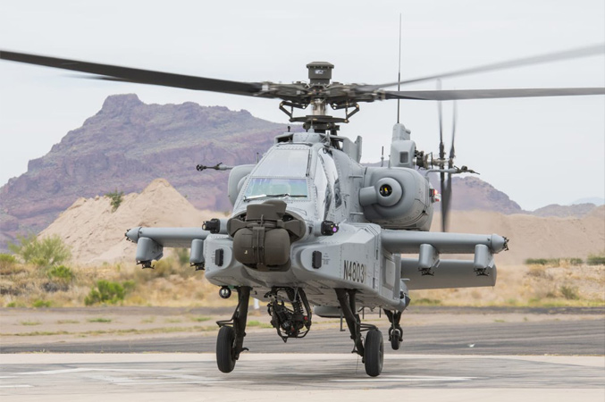

Beautiful. :love:
But I've so many questions. Please bear with me.
Pic 1 :
Red circles : Air-speed/direction sensors ?
Green circle : Comms antenna ? Radio or sat ?
Blue arrow : What is that ? a radar ?
Violet circles : Engine/Main gearbox cooling duct ?
Pic 2 :
Red circle : Tail rotor cooling duct ?
Blue arrow : Look at that, surely thats a sensor of some kind. What kind of sensor sits on the side ? Synthetic aparture radar for ground scanning and situational awareness ?
Pic 3 :
Red circle : What is that ? Just ahead of the engine intake, so does it compress intake air or something ? I've always wondered about this.
Green arrow : Looks like some kind of bay/compartment. Fueling bay ?
Violet circle : Rearward looking MAWS ?
Pic 4 :
Blue arrow : I know that's a TADS, but why wasn't it painted in camo. Do they not paint this part in Apaches ? Also over the TADS(arrow directly pointing at it) there seems to be laser range finder. Is that accurate or is that a day camera or something ?
Help me out here guys @randomradio @Ashwin @Parthu @Falcon @BlackOpsIndia @vstol Jockey et al.

Pic 1 :
Red : Yes - Helicopter Air Data System (HADS)
Green : Appears to be so. That would be the place a SATCOM antenna would go
Blue : Not sure - appears only the AH-64E model has that. Doubt it's a radar though, considering that's a bad place, its FoV would be mostly covered by the weapon pods - you can see in your own Pic 3 how this is the case. More than likely the volume of the internal components in that place got bigger, necessitating a 'bumped' surface panel to accommodate them
Violet : Yes
Pic 2 :
Red : Yes
Pic 3 :
Red : That's actually the gearbox
Green : On legacy models of Apache, that used to be a storage locker of sorts (survival equipment etc.), but those raised stubs on the panel are new on the AH-64E variant. But unlikely its purpose has changed.
Violet : Yes - rear aperture of the Elbit PAWS missile warning suite
Pic 4 :
Blue : That's the M/PNVS (Pilot Night Vision System) - it can operate independently of M/TADS (which is the gimbal on the bottom), although it is basically part of the same system.
Some customers do paint the nose in the same color scheme as rest of body (like Indonesia), but most of the time in majority of countries, the nose remains black regardless of body paint.
Hmmm........This bumped up surface panel is surprisingly deceptive. I could've sworn this was a radar. Does the other side have it ? Or is it just on one side.
Both sides.
It just doesn't make any sense for it to be a radar - as I said, about half it's FoV would be covered by the weapon pods if it was.
Furthermore, what's the need for a new radar on the side? If it wants a radar, it has the APG-78 Longbow on the rotor hub which can scan all directions, with a pretty good view of the ground around the Apache as well. And the Longbow is already a Millimetre Wave band radar capable of very high resolutions.
Both sides.
Could be a heat shield or some sort of extra armor plating to act as a buffer between the weapons pod and the internal fuel tank.
