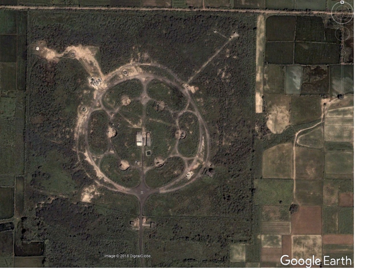

For example, This is the layout of a now-defunct SA-2 deployment location in North West Delhi.
Those were easy to locate and target. Newer generation of air defense systems became mobile. It can protect any area as you prioritize. Today its protecting Delhi tomorrow it can protect Pathankot.
But, It cannot operate on the move. It should be deployed first to secure the air space. For that role we have , 9K33 Osa (SA-8 Gecko) 9K35 Strela-10 (SA-13 Gopher) , Schilka and Tunguska.
