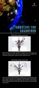

Awesome news (y) Kudos to ISRO,
5 nos. of 440 N thrust engines and 16 nos. of 100 N Reaction Control system (RCS) thrusters. Maybe these thrusters will be connected to the crew module during the re-entry to make the re-entry slower by burning these engines to reduce the speed.

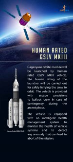

The first major technology is the human rating of the launch vehicle – the GSLV-Mk3. Most activities have been completed and the testing phase is progressing where we are checking for the robustness of systems. We’ll also need an integrated vehicle health management system which can assess the vital performances and parameters efficiently. It should only abort after taking complete stock of parameters accurately. Then there’s the crew escape system, which has also entered the testing phase.
The main system is the crew module which has a twin-walled structure that has to go into space, survive the pressure there, withstand the rigors of re-entry and splash down. This is also in the realization phase. The crew module, along with the service module, will form the orbital module. Then we need the environmental control and life support system that mimics the Earth atmosphere, which comprises thermal control system, cabin air revitalization system, pressure control systems etc., all of which have completed the design phase and some systems are undergoing testing.
