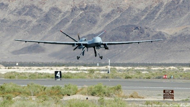

MQ-9 Reaper drone flies from Creech AFB
WASHINGTON: The Pentagon and India’s Ministry of Defense are working together to “tailor” a standardized version of the Predator B Reaper attack drone for use by all three Indian armed services, with officials actively discussing how to finalize the long-planned sale.
Key to revising, and finalizing, export of the armed unmanned aerial vehicles (UAVs) is the ongoing effort by the Indian Army and Air Force to define their requirements, and the parallel work by India’s MoD to ensure that the sophisticated drone systems can work with current service platforms and systems, says Ben Schwartz of the Chamber of Commerce’s U.S.-India Business Council.
“The weapons systems, the avionics suite, the communications suite — they all need to be tailored to India’s needs, so it works with their other equipment,” he told me on Wednesday. “Then there is the issue of integration with their other platforms.”
File photo : Dr. Ajay Kumar, Defence Secretary of India.
Ellen Lord, head of Pentagon acquisition, confirmed to reporters at the Pentagon on Monday that the negotiations with India are ongoing. “We continue to work with India on that,” she said, adding that “Ajay Kumar was just over here about a month ago, and we continue to work through that.” Kumar at the time was the MoD’s secretary of Defence Production; he was promoted Aug. 21 to the post of Defence Secretary.
The Indian Embassy did not respond to a phone request. A spokesman for prime contractor General Atomics was unable to obtain an approved statement by publication time.
