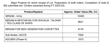

where did you read that talwars & shivaliks are getting MFSTAR????

i'll believe it when it happens. The costs written don't make sense. The entire proposition doesn't make sense. You cant just willy-nilly change the main radar of the ship. Requires a lot of investment in changing ship superstructure & weight distribution. Add to that you'll be ditching Fregat M2EM, MR-90 Orekh, Shtil-1 combo. Then you'll have to pay to modify the russian architecture to add MFSTAR+Barak8 [which in itself is extremely expensive]. Nah.....makes no economic sense.
Most likely the arm launcher will be replaced with VLS launched shtil and the klub missiles will be replaced with brahmos. This will increase its offensive & defensive capabilities while being cost effective.
Missiles are paired to certain radars. You cant just drag & drop missiles and pair them up with other systems. Why do you think Shivaliks are much more expensive than talwars? Its the 2 different SAMs that come with their own Illumination radars & search radars.

The MFSTAR-RA (presumably meaning Rotating Array) projected for Shivalik & Talwar upgrade, would likely be something very similar.
If the upgrade program is pursued, that is.
The land based LB-MFSTAR has a rotating array. Perhaps that's an option for Talwar MLU. That's just one option, though.
