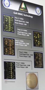

DRDO is working on GaN based wide band arrays for ESM/ECM. This is a part of the naval Shakti EW suite upgrade program:
Various radar micro-electronic components. Among them the 130W GaN HEMT:
