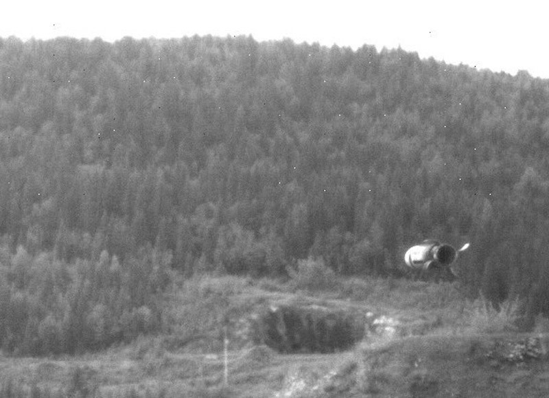

This is our developmental 155mm ramjet shell, test fired by NAMMO. Range 150km+.
As of December, 2019 150 test firings have been conducted.
NAMMO is also in the process of developing a ramjet powered a2a missile with a range of up to 400km.
