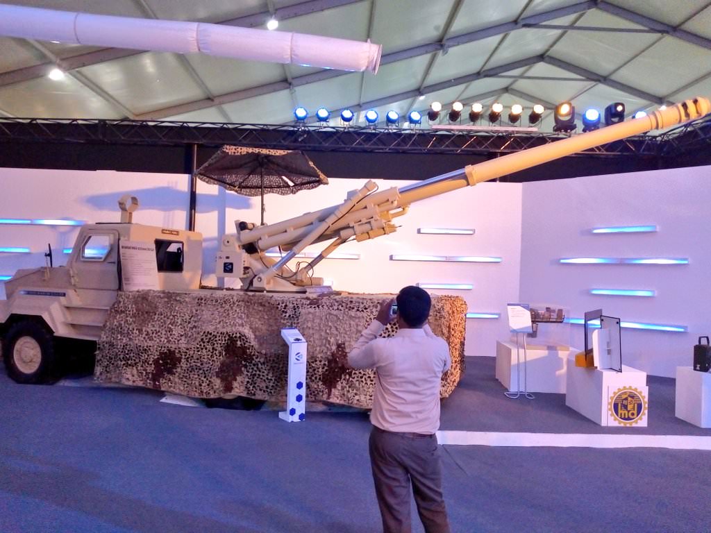

IA seems to have settled for 155mm though. And BF has already made a 39 cal version based on the ULH.
BF has also made an MGS based on the Humvee and a 105mm gun. It's called Garuda-105.
Garuda-105_ultra-light_105mm_field_gun_mounted_on_Humvee_Kalyani_group_India_defense_industry_Defexpo_2014_001.jpg
Yep. There are enough indigenous solutions, especially by the time the program starts.
There was a report on Kalyani 39 cal mgs that, IA isn't interested on 155/39 cal mgs & they want 155/52 cal mgs.
